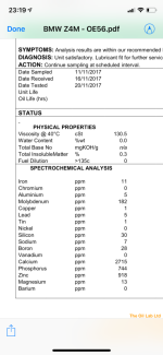

Here's a couple of report from the same car aafter a rob bearing replacement...
5,000 miles after:
Another 4,000 miles later, after a change in oil brand:
Here's one from another car:

The only other cause I can think of, is if you've tried one of those 'miracle' oil additives - which often contain lead & copper as 'lubricants'...for example (identifying bits redacted for confidentiality):

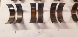

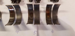

So the shells are now replaced, bill came in at just over £2000, £1414 including inspection 2 and the rest on replacing other parts that showed wear. Vanos and differential were fine so that was a bonus. Pictures of the shells below, wear was mainly contained to the top shell with cylinders 4 and 6 being the worst.
Happy to have had this done as now I can chill and enjoy the car:)

Good grief - those bearings looked horrible! I'm still stumped as why copper are not showing on these reports as expected.
Glad to see you had it done (just in time too) so you can really go enjoy it without worrying about bearings now :driving:
