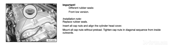

From TIS
Mount all cap nuts without preload. Tighten cap nuts in diagonal sequence from inside outwards.

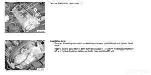

Wonderful thanks as ever chaps! Ordered some Three Bond 1209 sealant. Best just follow the instructions.

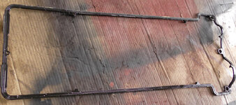

I did the cam cover gasket today. The procedure was easy but the findings were unexpected.
The existing gasket was completely saturated through with oil. I've seen leaks before but never gasket failure on this level. No idea why.
I also noticed that there was no evidence of the 6 beads of silicone that are required, again not sure why.
