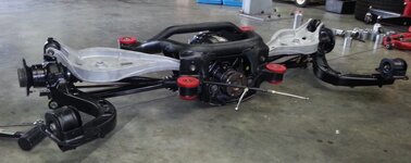

Here you can see a pic of the rear axle bushings and diff bushings. the last ones are the RTAB's. You can see I got them out without any damage; just popped them out :D
I dropped the axle, and once dropped I had all the bushings removed (17 bushings!) in about 3 hours, so roughly 10 min, per bushing :wink:
Sandblasting, painting etc all the rear axle components.....now that takes time :lol:
But after that it's all lilke new (and fully polybushed :wink: )
I did this in 2013, so quite a while ago (and I have to mention, my car was in pretty good nick rustwise)
(you can still see the bits of my bushing extractor set in the background :wink: , and apparantly I used a deadblow hammer for something in the assembly as I see that lying in the foreground.... )
