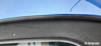

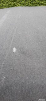

I have taken some photos of my hood marks, not the best photos as I had to wipe the rain off the hood.
Drivers side
Passenger side rub mark which I caught just in time

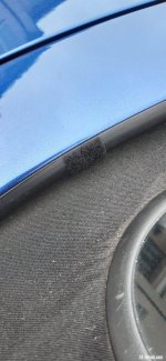

Resurrecting an old thread; my roof has the usual two wear marks. I checked that the rubber seal is pushed back, so I placed a couple of small patches of the "furry" side of velcro tape where the roof touches the rubber. Hopefully there should now be less rubbing friction on the roof material.
I think that’s going to lead to localised wear patches in the spots you’ve positioned those patches :?
Rob
Rob
You may well be right.
I believe my other option is to try to shift the hood a tiny bit forward, but I don't want to mess with the closing action if I can help it.
OK, changed it to electrical tape. Looks better and should be slippier.
I filled the "holes" in the roof with Stormsure rubber glue. Looks OK, but not brilliant. I'll work on it a bit.
