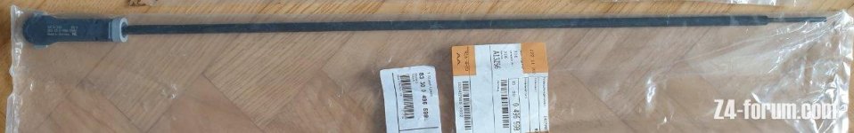

Look how to and see the manual download.
I think someone did buy a tool online somewhere.
Look here;
https://www.facebook.com/groups/zscca/posts/10161189990334429/
It’s called a release tool, part number 83300496598.
Seems like a tool that should be in a car tool kit.
Well it looks like a very long hex key. Anyone know the size?
https://www.bike-parts-bmw.co.uk/bmw-motorcycle/assignment_spare_parts/83300496598
Actually just checked that site, 40 euros with postage, forget that.
Look for some hex. rod.
So i saw Robbz on another forum suggest it was a 5mm Hex.
Think i'll make my own tool just in case.

So i took a closer look today.
There is just a 5mm diameter hole (there is a 5 stamped above it) so looks like no special tool required, just a long 5mm diameter rod.

I think i will make another tool and leave the tip at 5mm,
I had made it with a 4mm, 7cm long section which did bend slightly in use.
It is virtually impossible to see what or where you are pushing.

But i think the BMW tool is just something they have that is just a convenient rod, not a special tool.
p/n 83300496598
IMPORTANT: don't use this tool under hydraulic pressure!! The correct emergency valve has to be released. Nothing to play with if YOU don't have any clue from this hydraulic system. You may destroy your hydraulic pump or any of the other hydraulic components. Jmy2ct
That's what's happenning when pushing with this tool (red):
The white metal plate will be pushed to the front to mechanically unlock the coupling. As said, may not be pushed under hydraulic pressure!

Hi Robbie
Brilliant, thanks for that picture...its exactly what i have been looking for.
I have released the pump for the boot section only at this point...will release the other valve prior to lifting the roof out
