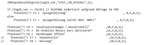

*.IPS are scriptfiles and can be edited. My jbbf.ips has the following function:
SCREEN s_steuern()
ftextout("< F4 > Zusatzwasserpumpe / Wasserventil" ,10,5,0,1);
ftextout("< F5 > Bi-Stabiles Relais kurz aktivieren" ,12,5,0,1);
ftextout("< F6 > Heckklappe öffnen" ,14,5,0,1);
This is the required function!
ftextout("< F6 > Open trunk lid" ,14,5,0,1);
As changes have to be compiled, currently it's not an idea to update a *.ips source file.
Attached my jbbf70.ipo object file.
This is mine
ipo-fault-jpg.288407
There is a movie "the fault is in our stars" and here the fault is in the two slashes...
I will remove them and hopefully it will work

This is mine
Morning,
No, no, no.
This is source code, double slashes are comments or deactivated lines.
"F6 Heckklappe öffnen" is the correct function for the trunk lid, so nothing has to be changed.
An updated source has to be compiled before it can be used, just changing anything in the source doesn't help /work.
Did you compare the files and folders? I assume, JBBF70.ipo has to be used for our E89.
You could try to connect with a 3-series E93 in INPA and open the JBBF form. Maybe you'll see the F6 + F6 function to open the trunk lid.

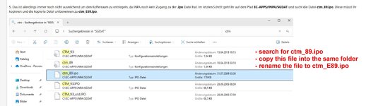

I found a hint on ZRoadster.com regarding the JBBF configuration to be able to open the trunk:
  1. Step JBBF: check the correct JBBF naming in E89.ENG
  2. Step CTM
Update
I assume, that the same result can be achived by just correcting the CTM config line in E89.ENG from CTM_E89 to CTM_89 and without copying a file.
