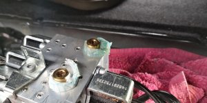

My e89 roof motor is leaking.

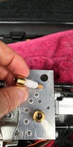

I found the problem (a burst O-ring seal in one of the brass hex screws on top) - see next post.
