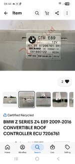

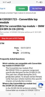

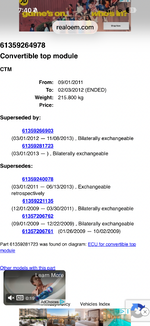

Hi again, sorry to be a pain, my current one has the code 09264978, if im doing it right it shows this on reoloem....I really want to get this sorted so I can get the roof down....apologies but I havent got a clue with this as I have been told so many things....
These are the modules realoem says are cross compatible with yours

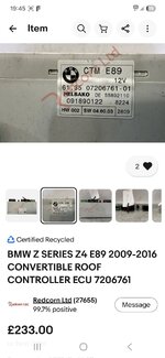

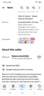

Will do, I have asked them to confirm it will fit mine...and they say 30 day returns
Summary:
  • The SoftClose functionality to lock the trunk lid is managed by the CTM
  • Generally, each version will work on E89 hydraulic pumps with 4-solenoids (i.e.with a tiny reduction of it's functionality below 6.50.00) without coding
  • Your current CTM has a software version 6.30.00. This is the highest version to manage E89 hydraulic pumps with "only" 3-solenoids
  • Each equal or lower version can be taken pnp, without any coding
  • Software versions above need a downgrade of the software, also new CTM's from stock
  • The missing 4th solenoids can be simulated by a resisor to be added on two pins of the green connector on the harness at the CTM
Hiya, thanks for the response but tbh I am not that technical when it comes to these things so need something I can plug in and hopefully it wil just work. I have just been offered a deal on this unit.....does anyone know if this one will work? It says its compatible.with my car
