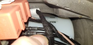

Hoping it is a bit low due to never having been topped up before! Should this type of fluid never go low?

If the roof is operating ok, and it's already been pointed out that the reservoir should only be half full, then may I suggest a photo to get opinions before you over fill it?
Hydraulic jack oil is also suitable and far cheaper than BMW stuff. It should not be overfilled as the others have said, space is needed when the fluid is expelled from the rams when it closes.
Here's a photo, not easy to see but hopefully ok to see the oil level. It's just below the minimum line by looks of it. I've looked around the boot but all looks very dry. Anywhere particularly to look for leaks? Roof operates perfectly.
