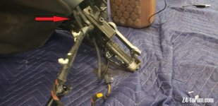

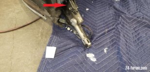

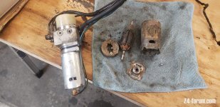

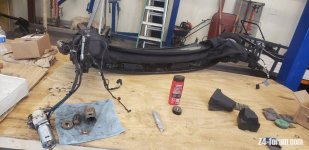

Hello, I have a 2003 3.0 soft top Z4 that I have done alot of work to and have finally gotten around to replacing and relocating the roof motor. After some time I managed to get some movment out of the top only to have it pour fluid out the "roof lift struts " <---what is the proper name for these? Any ways are these something that can serviced or rebuilt any help even a " no way mate youre screwed" would be helpful, and if i do have to replace them does anyone know an affordable after market source, currently the only one I seem to be able to find are like $500 a piece. :o anyways Thank you in advance for your help.
BMW calls them "hinges". If you are in the states you can have them rebuilt by Top Hydraulics in Oregon. https://www.tophydraulics.com/55-bmw-z4
I just called top Hydraulics and its $950 to have refurbs sent to me and a $400 credit when I send my cores in 2 weeks lead time , and or $500 to have mine rebuilt with 4-5 weeks lead time, Has anyone tried successfully to just delete the hinges and make the top manual?

However, Its unusual for the hinges/rams themselves to leak. It’s usually just from the elbow on the lower hose where it enters the ram.
I have changed a Ram once and it’s a pig of a job, as you need to get both sides identically aligned, otherwise the roof doesn’t sit and move squarely as it reaches the windscreen.
