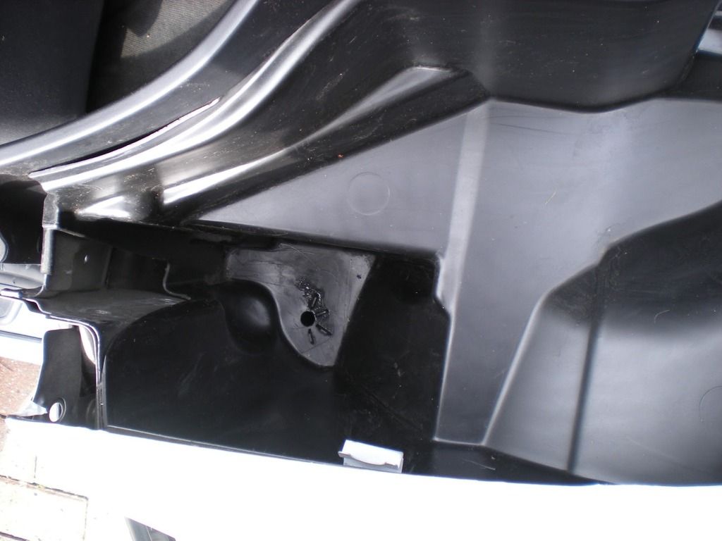

That's what it looks like with roof removed

In front of rear wheels look up and you'll see a black tube
That's the drain tube
Now get a wire coat hanger
Cut it, bend it all straight
Get a load of warm soapy water and and with roof down and stopped about 2 inches from fully down
Pour warm water down into housing at the two ends
Watch and see if any pours out under rear wheels
If slow or not at all
Get said wire and gently push it down the gap behind motor and using above pic mentally note hole position and gently Pole round till find hole
Once do simply and gently push wire in and you'll see the water run free
Keep filling up with warm soapy water till runs clear and freely
Repeat other side
if badly blocked, from under car said wire can be pushed slowly and gently up the drain tube to free blockage
Hope helps
