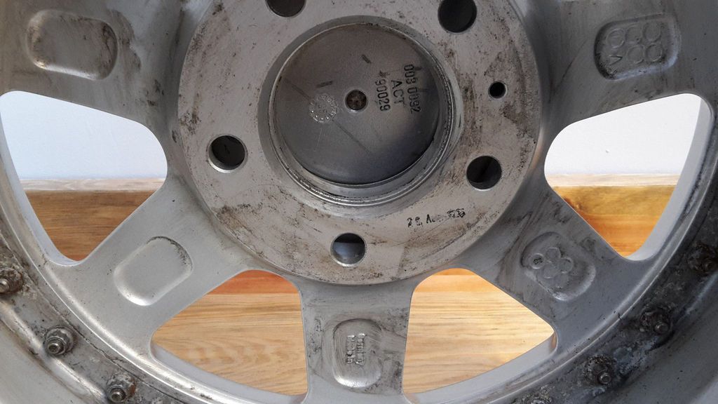

These are the Ronal / ACT SX
I found 4 off in 8.5x18 et13, and then 2 more 9.5x18 et18 so 6 wheels to do, which works out well as I can swap them between my VW T5 and the Z4 as they are the same PCD

Made a start today, having done these in the past, the amount of bolts you have to undo really does you in, so I did these with my new to me air gun
This saved hours of work taking about 2 hours total to remove all 282 bolts
Bit of heat on the barrels and dishes they split easily
First job is to get the centres over to TT Tools to have the rear faces milled down to increase the offset,
Mine have a lot of meat in the bolt holes compared to et40 centres so will be turned down some

Had an early start today , on the road at 6am to get over to Chelmsford to see the lads at TT Tools, they machined my faces on the rear pads to get them to a higher offset taking 18mm off the rear face, also got 4mm taken off my 19's whilst there. Can't recommend these guys enough for wheel modification .
