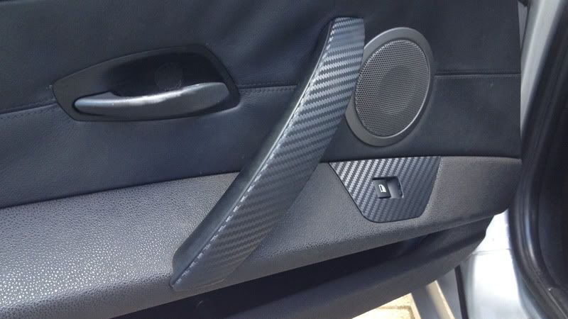

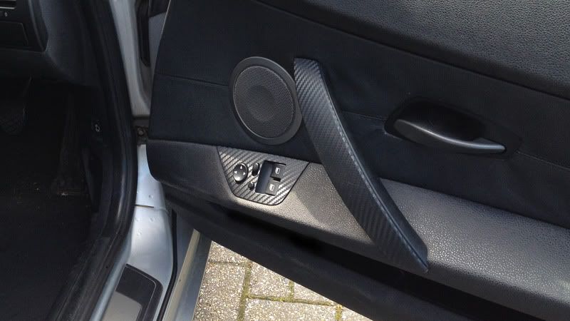

Got bored tonight, so dug out my old steering wheel trims and grabbed some spare 3M wrap I had lying around, the results:
Not sure if I'll fit them yet, it may be too much carbon... I may even lacquer them to see how they end up, as they are spare after all

but isnt the carbon pattern different on door grab handles, ie same material just direction is wrong :thumbsup:

Car looks like it's coming along fantastically, though looks like you CF wrapped your grab handles in the same way as me (thatch going in different directions) - according to Bing & srhutch, it's a Forum no-no & alegedly will bug you after a while - However, am still waiting for it to happen...
Anyway, does this now mean the car's now mechanically sorted so you'll finally be able to make it along to a hoon?
I've been told this is incorrect elsewhere too, but it doesn't bother me yet. As far as I can tell, I only have one to re-do, right?
I have enough spare to do it, so maybe I will :D
