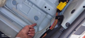

Ok found the leak. It's coming in through a floor joint and starts pooling when I flood the front end of the car and it's running down the side box sill section and out the back wheel area. Somehow it's getting in at this place I'm pointing to. . Any one got any ideas

OP, where exactly is that? Is it under the driver's seat to the rear? The panels are spot welded, you can see them. Is there any sign of movement of any panel; ie has one become 'unstuck'?
Yes, to the rear under the seat back corner area. Right where that sealant meets the joint. Nothing looks unstuck. Hose pipe around the front engine top area and drain areas on the windscreen cowling. Then it runs down through a drain or sill section and out the back by the wheel.
Somewhere along the way it manages to come up out of that welded section ....
Not sure what's going on but we've sealed underneath the whole area and inside for now to see if it stops.
