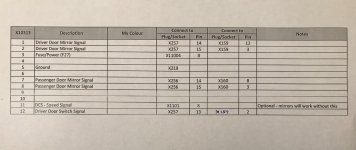

I'm looking at couple of ways on approach ;
1) power folding only with minimum wiring, like Ron did in the US. (look at the attachment, which has the pin out numbers for x257 connector, this is the connector that runs from the door to chassis.)
2) Second option is to add all of the wires to the module to gain the heated mirror, reverse tilt, dimming, key memory, speed fold etc....This would also require coding which is not a problem, you just have to add SA430, SA313 option to your VO/FA. (I have the code parameters for the mirror option settings) Again, I need the wiring diagram to verify all of these.
I have the door looms from the donor car, which was a RHD UK 2005/6 Zed, I will compare the connector wires to my car and let you know the differences.

I just got some drawings on the module/mirror section and it seems relatively easy to integrate.
8 out of 12 wires are used from the module, 2 being power, 1 to DSC if you want speed xKph folding option and rest goes to door modules which are the window/mirror switches.

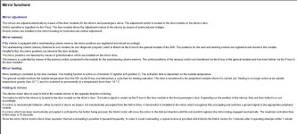

I have some drawings/information on the vehicle wiring, that I'm attaching along with FA/SA numbers should you wish to add to your VO. I'm going to the dealer sometime this week to see if I can purchase the plug connector. If the dealer is no go, then I will look for it in the UK or back home (US), as I'm not aware of any salvage yards here in FR.
Thanks again, :thumbsup:
I got these SA numbers from bimmerfest, just can't remember the link
S430A Interior/outside mirror with auto dip
S313A Fold in outside mirror
E85 Vehicle electrical drawings - mirrors.
I know the attachments are hard to view, if you need pdf let me know.

That looks like the TIS diagrams and description....
My setup is for a RHD car and I don’t know what extent the LHD cars may be different, but I’m sure the TIS reference will clear things up
