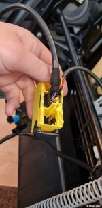

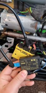

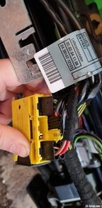

This is my first post on this forum. I've been struggling to retrofit my new heated memory seats into my Z4 E85.
I have been looking at the differences between my new and old seat connectors and noticed that the connectors support two different occupancy sensors.
My old seats have the occupancy sensor with module, where as my new seats don't seem to need that module.
The harness in my car has the second oval shaped connector running from the seat belt buckles, my new seat just has it run straight to the connector.
Will I need to buy one of those bypass modules I'm not sure how they work or which one I will need, or am I supposed to wire in the secondary oval harness in my car into the big connector so that it works with my new occupancy sensors?
I will attach some pictures, I would prefer to use the module less occupancy sensors but if not I could strip the seats and swap the mats so that its plug and play with my wiring harness in my car.

I’m just playing with a similar set up here
I fitted on the passenger seat a bypass for the occupancy sensor and a seatbelt clip bypass, however the drivers seat is now causing an alarm so I think I need to bypass that belt too

Regarding sensors you just find the right resistor and bypass it. I used resistors on my track cars to bypass the airbag sensor alarm.

Thanks for the replies, which sensors will I need, and where do I plug them in?

So I bought the bypass and installed it but now I have an airbag warning light that won't go away, what should I do?
I just bought a OBD cable so I can plug into a laptop since my cheap OBD handheld reader doesn't pick up the airbag faults.
