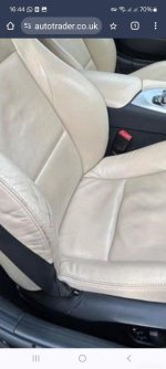

Photo shows the level damage, also seat looks a bit grubby, slightly surprised as the car has done less than 60000 miles. Although white/cream interiors seem to look grubby in most adverts. Do they just photo badly?

They will clean up but the bolster will need paint.

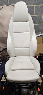

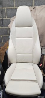

The seat below is canberra beige buts it nappa leather. The ones in your picture are Kansas leather.
These have been cleaned:
The below shows the seat base and only the left damaged bolster have been painted:
So when cleaned the paint will match well.

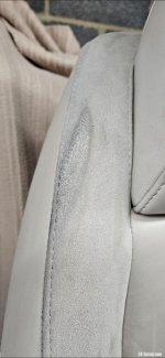

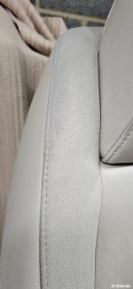

I originally got it for the alcantara but found it equally as good on the leather.
Alcantara before:
After:
Your a man of many talents, those are incredible results on alcantara :thumbsup: . I'll definitely be taking your advice and trying this out soon. thank you again :thumbsup:

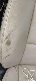

I got really good results with the colourant from scratch doctor https://thescratchdoctor.co.uk/product-category/auto/car-brands/bmw/
I used a cut up washing up sponge to apply . Use the smooth side. I did 4 coats. The 250ml bottle is around £17. Leave at least 15 minutes between coats. It has stayed looking good months later. There is loads in the bottle so probably enough for 4 seats. It was a perfect colour match. The main worn area was the left bolster which now looks like new. Don't worry if it looks patchy when applied. As it dries it will look great. But definitely use a cleaner first - I used Autoglym leather cleaner but it looks like other forum members got great results with the diluted Woolite.
Nice job. Light coloured seats when worn like that just look terrible and really make the interior look bad. Well worth a bit of time to learn how to do it and patience when painting, but great outcome!
