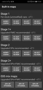

MHD is purchased in two parts, the app itself is about £100, then £45 for each map.
Obviously it would make better financial sense to upgrade the FMIC and Decat before MHD, as you would only need to buy the app and Stage 2+ map.
Once you purchase a map, you can flash any fuel version, and you have access to any updates. V7.1 is out at the moment, and V8.0 is in beta.
The map options make take MHD from a good to great tool in my opinion. The exhaust burble is especially good fun - In the latest version you can even choose the burble aggressiveness and to only have it activated in sport mode.

The definition of stage levels is just a general consensus on the platform, not really a defined set of upgrades and has no bearing on how other platforms define stages. Most people class stage 1 as purely a software then stage 2 as simple bolt-on modifications (Intercooler and Catless downpipes).
