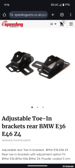

If you have an issue with toe then replace 17 in the diagram with adjustable toe plates…that’s what I did on my E89 whicj is essentially the same suspension system on the rear…together with adjustable camber arms..
Also if your RTABs bushes are old and set they affect it..maybe time for fresh RTABs and associated bushes..
Adjustable camber arms and maybe these adjustable toe brackets https://www.speedingparts.co.uk/p/chassis/car-suspension/steering-system/adjustable-toe-in-brackets-rear-bmw-e36-e46-z4.html .

The issue with the E85/E89 trailing arm rear suspension is that camber and toe are affected by each other …hence why it’s often required to have both more adjustment on the camber arms and adjustable toe plates..
The question is the cost of those changes worth the effort..
If you put fresh toe plates in then really you should refurb the various bushes in there..plus the issue of RTAB limiters..

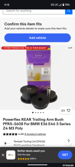

So from what I'm reading, I need some parts like these in the pictures and adjustable camber arms?

Yes amongst many other offerings…you need to consult the E85 gurus on the RTABS..personally I would used Meyle HD if I was on a budget and Hardrace if I wasn’t.. :thumbsup:
