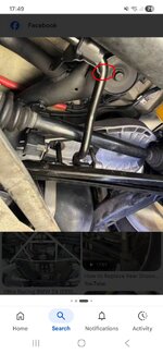

Do you mean the bit circled in the pic?
If so, it is close but equi-spaced both sides. So it clears the mounting bracket both sides....Just!
That’s it
I’m struggling to recall but I think we assumed it was equal spacing
But it wasn’t
I’m still trying to think of other things it could be
Are the springs seated correctly?
I believe so, the rubber spring seats are present top and bottom.
