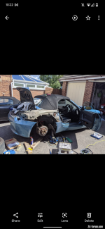

Look for Simon's write up..you don't need to loosen the roof or the shelf. It's a bastard to get to but it can be done.
I did it without removing these, ignore the carnage, you can see the roof is still clearly attached :)
How did you get to it? I have tried many different ways and the only one I can see is removing the 7 bolts holding the back of the top to the car and pushing it down to gain access. Haven't tried removing the carpet in the trunk yet. But reaching my hands in there I can't feel a thing.
B328iC said:
I pulled the weather strip (rubber) out of the way and pushed the roof down till I could get in there, it's a squeeze mind!!
