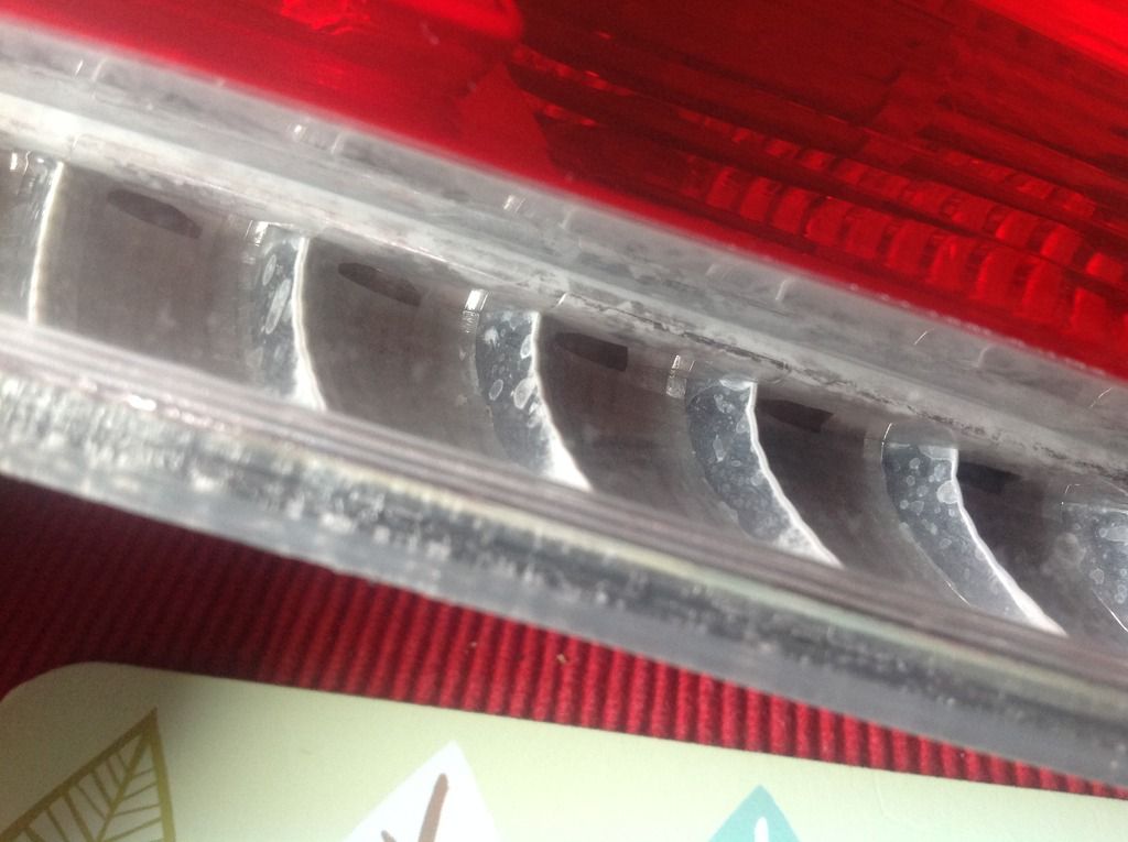

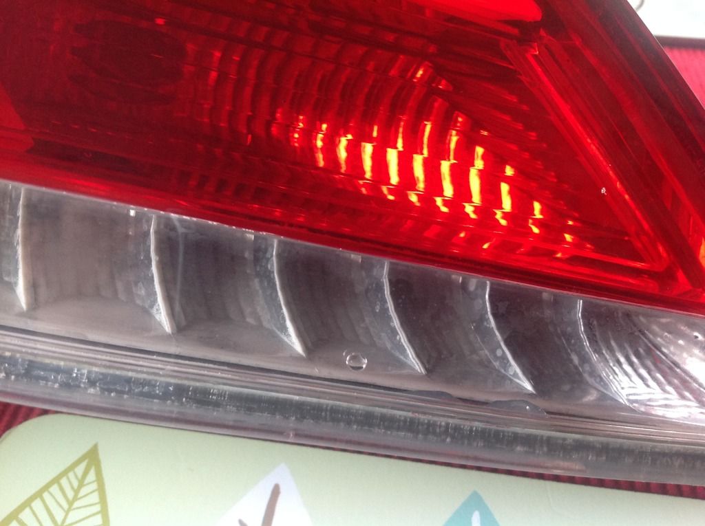

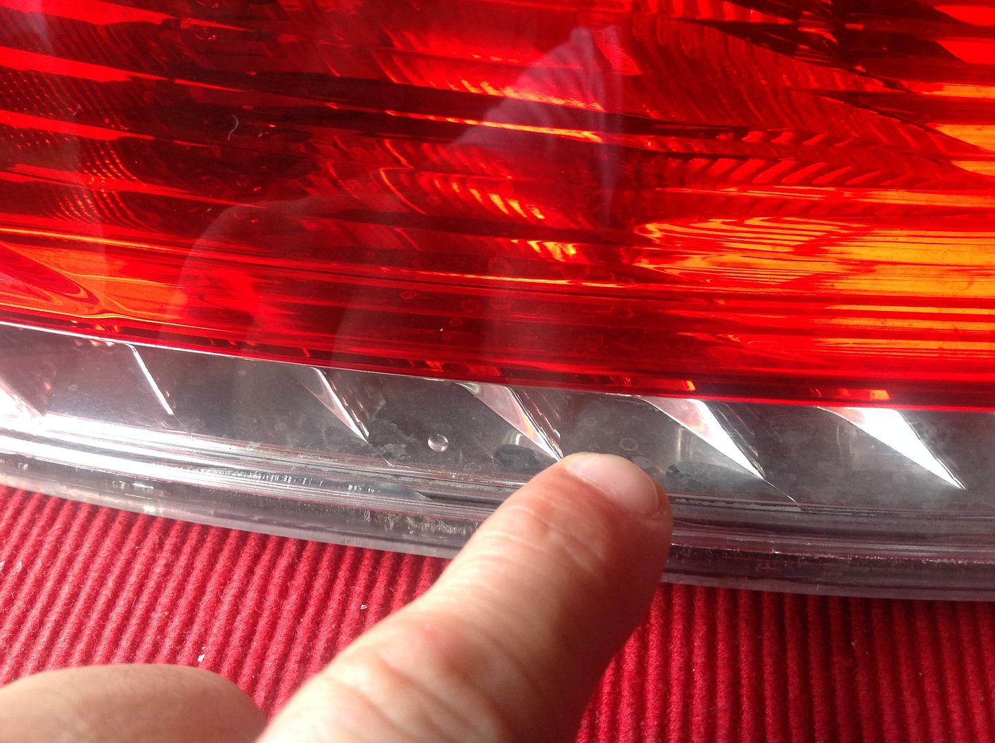

If you think you lights may be suffering from water ingress, you need to look at the bottom white/silver indicator section of the lamp to see if you have this sort of thing

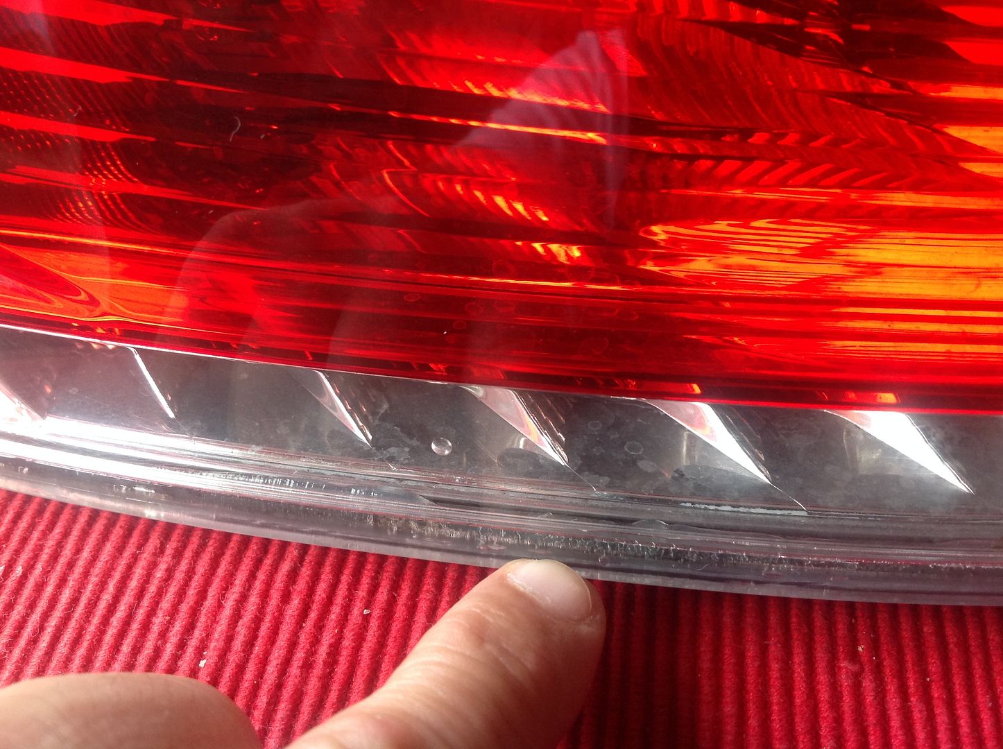

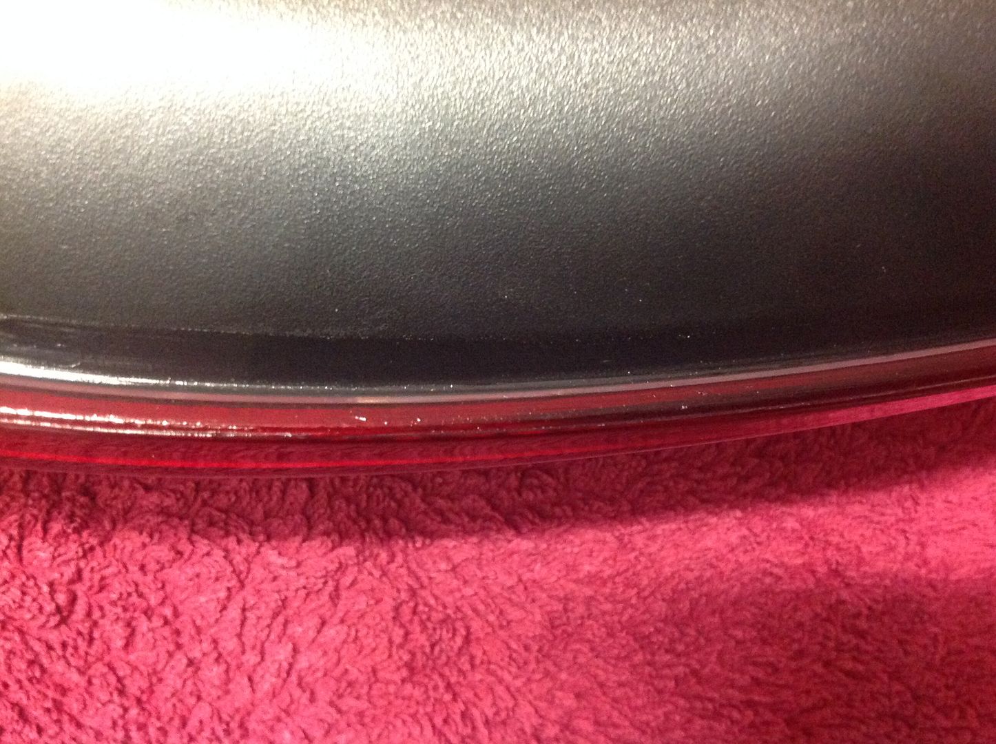

Next also look at the edge of the light lens here and see if it looks like this
If it does, then it's a good bet that the seal between the lens and the housing has been compromised too, a frosty look here is a bad sign .

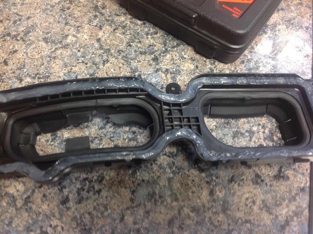

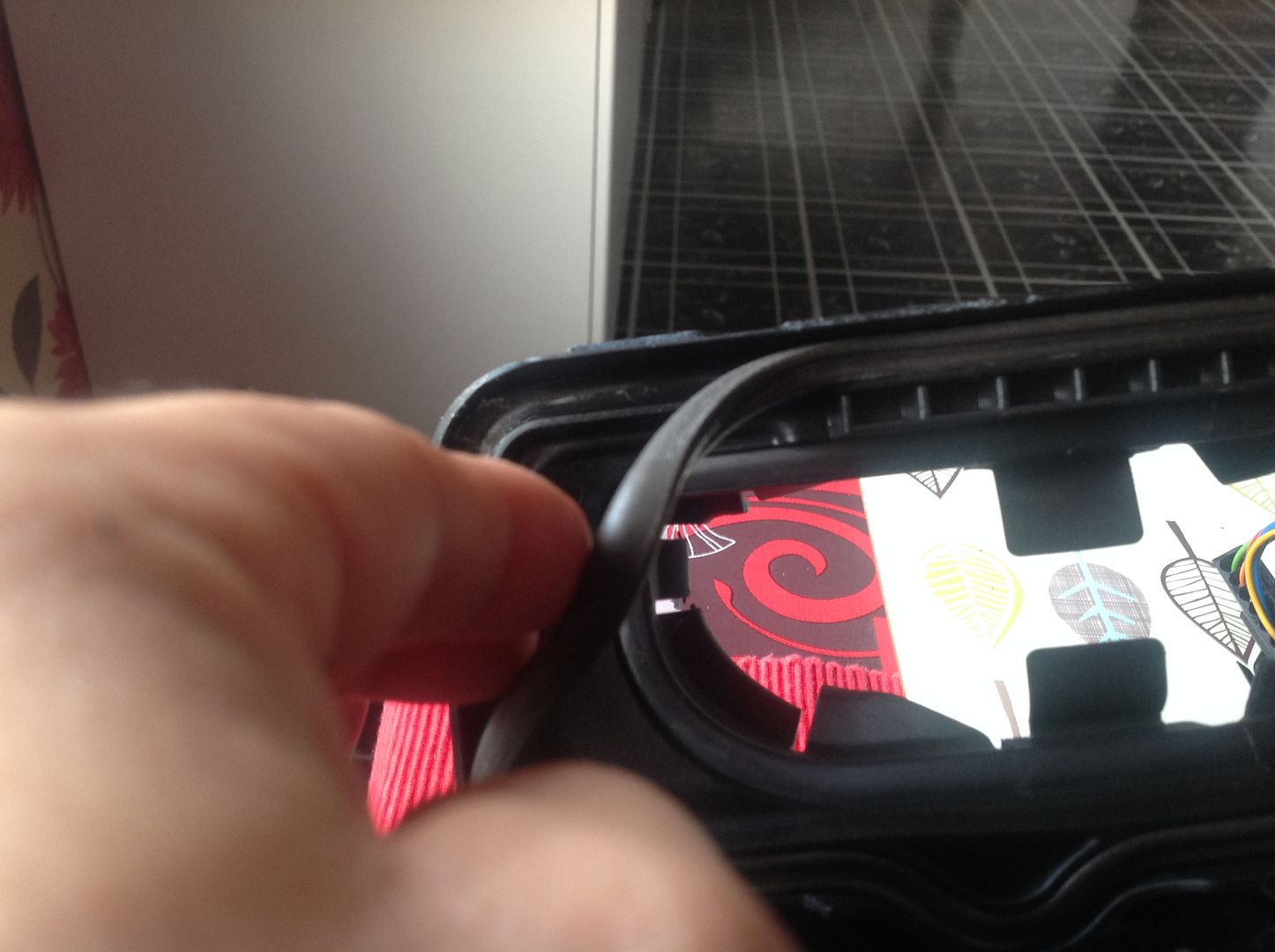

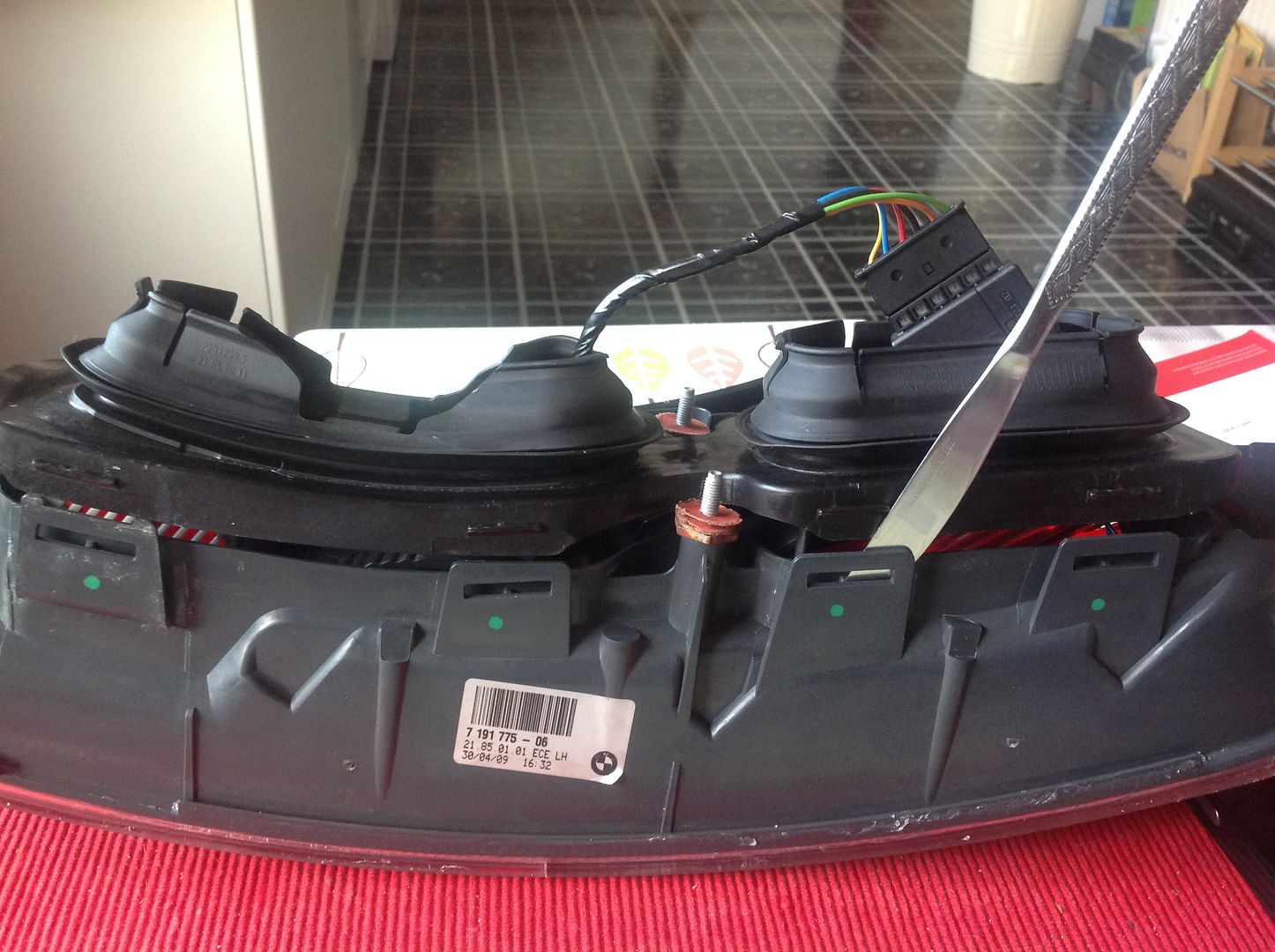

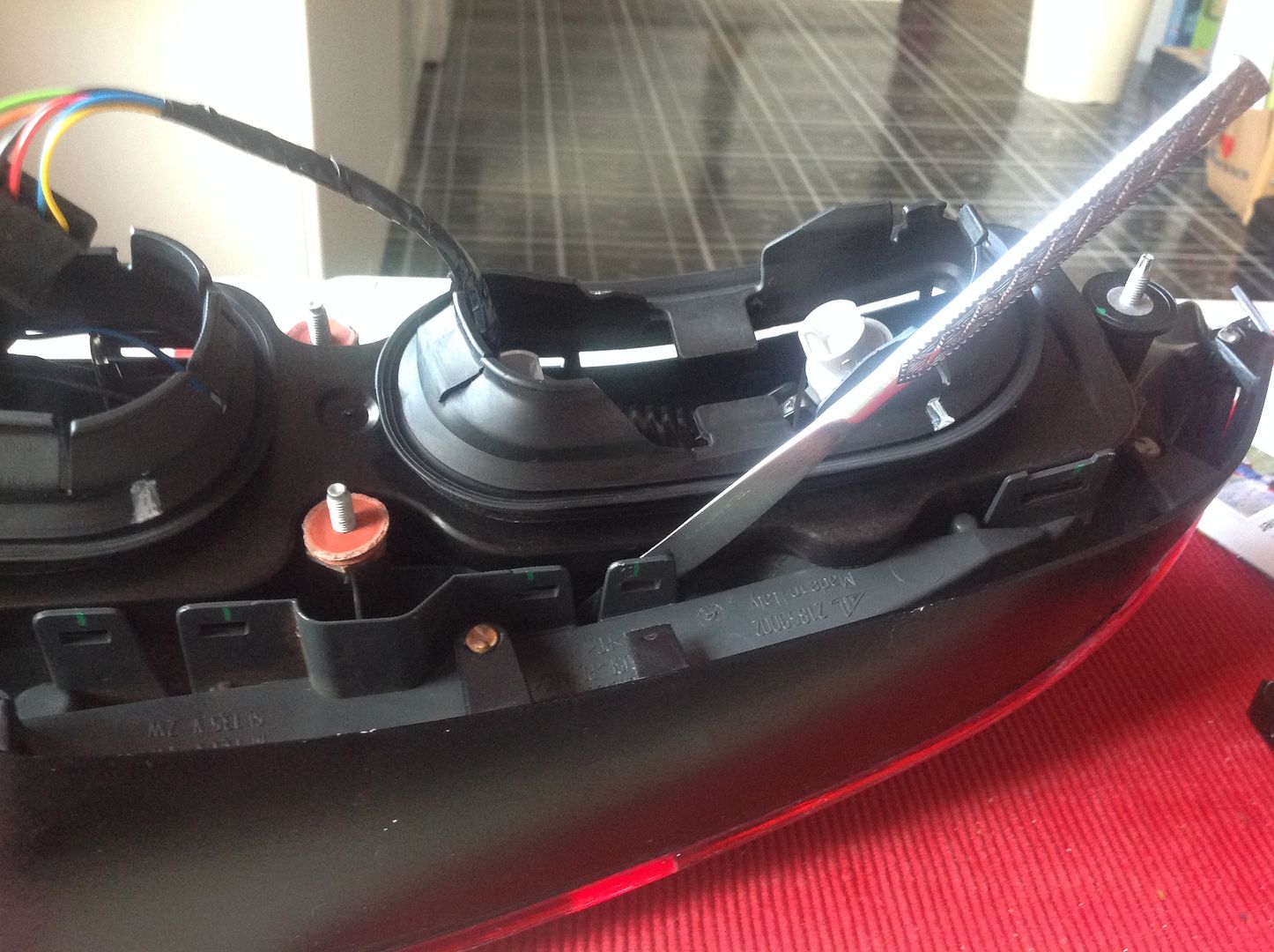

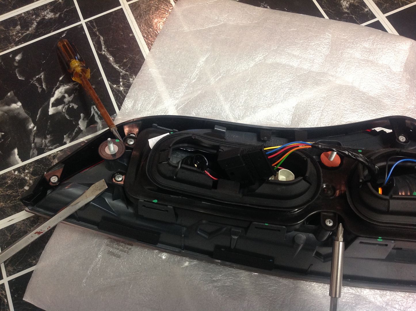

With the lamp removed from the car , clean off the debris that will be around the rubber seals that seal the lamp into the back panel . Then carefully remove the seal panel by prising it off like this

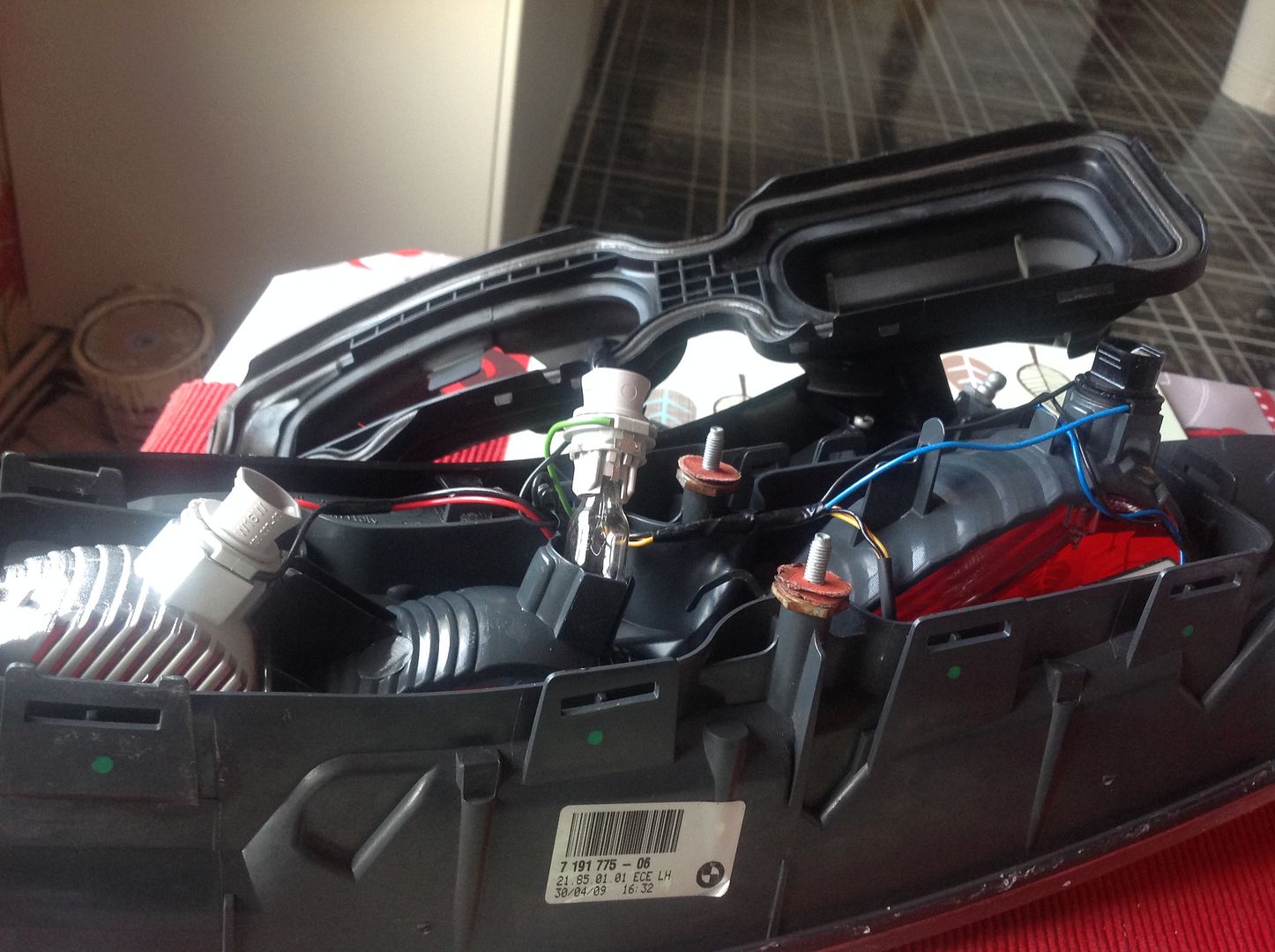

This will then reveal the seal that will also cause issues if not attended to , as its porous and soaks up water eventually , also one of mine was fitted poorly which doesn't help .

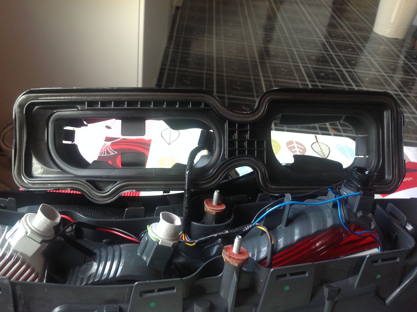

You will note that the the bulbs ( apart from the indicator led's which are not replaceable ) can still be removed with the seal panel in place , so don't worry about the next bit, which is basically sealing the panel onto the grey housing to prevent water ingress.......
Clean the lamp lens and housing joint , where the lens meets the grey housing , where is may be compromised. Clean the seal and seal panel, dry them throughly , dry the lamps out thoroughly in a airing cupboard or on a radiator etc until the lamps and seals etc are completely dry.
Now refit the seal into the plastic holder( the googles plastic trim with rubber seals ) then run a bead of silicone sealer around the refitted seal and replace it on to the rear lamp housing and push it firmly into place on all its clips whilst the silicone is still wet .

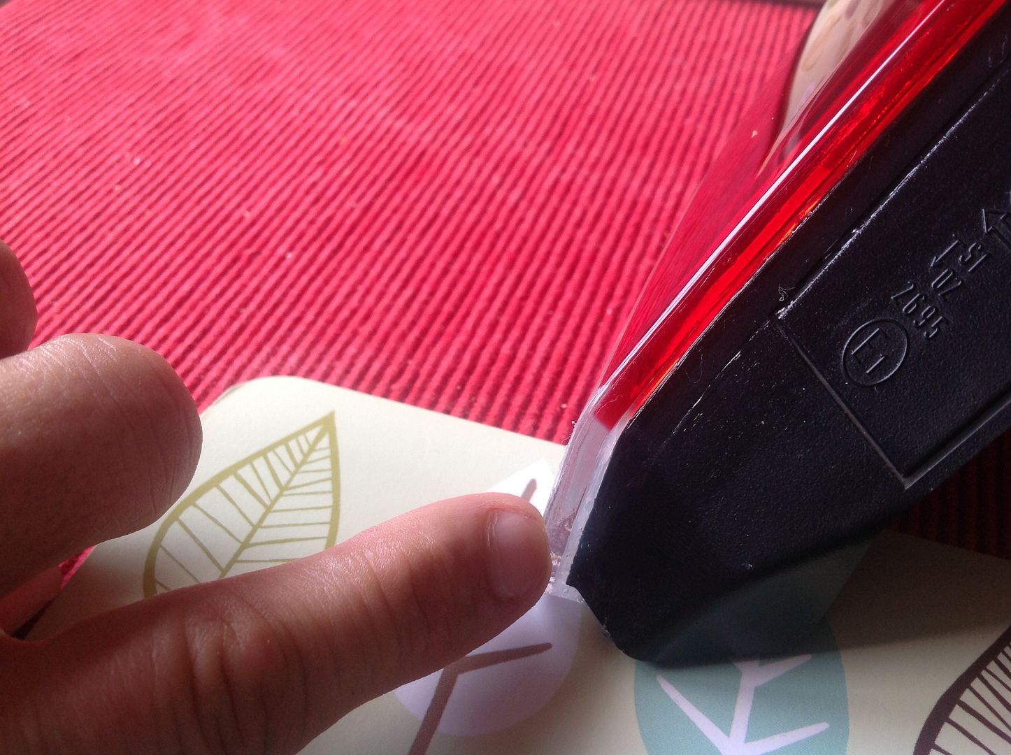

Now run a bead of silicone sealer right around the lamp edge between the lens and grey housing , smooth the joint off with a wet finger making sure the gap is full of sealer , do not worry at this point about excess, this can easily be trimmed off with a sharp knife when the silicone has dried , but try and fill the gap fully with silicone sealer .
Refit the lamps and hopefully the water ingress issue will be sorted. It appears the bottom edge of these lamps crack away from the inner housing whilst flexing when the roof is operated . And the seal inside the plastic holder is made of open cell foam which allows water to soak up and then bleed into the housing eventually . Crappy design .

My first and second attempt to seal to the lamp housing I used silicon sealant without success.
Finally after stripping off the sealant I used a liberal amount of Evo Stick glue and that finally sealed the units.

I'm not a expert on this , but I managed a large commercial body shop for years , so I have some idea , but flexible silicone sealer should do the job if applied correctly , it needs to be a nice thick bead, about 4/5 mm , not a thin smear, and both surfaces need to be clean and dry for good adhesion , for a good seal .
The lights cracking at the bottom edge could be caused by flexing as they do move ( BMW tech mentioned this to me ) as the roof operates , but it could also be that if water gets into the light through the seals it sits in the bottom of the light, and in cold weather it then freezes and cracks the bottom of the light . I've seen at least one this week that was completely detached from the grey section of the housing .

I ordered a new lamp from ECP that arrived today , and the rear seal is slightly modified in that it now has screw down tabs on the goggle seal plate and as others have mentioned one less mounting fixing. I sealed the plate down again like others I have done and ran a bead of sealer around the external lens to housing joint before installation tomorrow .
I had a new pair from ECP with the modified backgasket but i've just noticed today there is condensation on the inside of the nearside lamp, so that will have to be redone.

Have just finished drying out and reasealing my nearside lamp as above, will refit when it stops hissing it down
