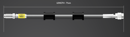

I'm about to replace the rear 2 Flexi brake pipe set up with 1 continuous Flexi pipe as some of you guys have already done. Does anyone have the correct length of pipe I need to get made up? I think it should be 720mm including fittings but would like confirmation before I get them made

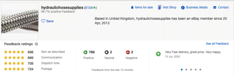

Got them off this guy on Ebay Good to deal with. Once he has your car details he should know what end fittings are required
Thanks for the quick response
I have sent a message to Hydraulic hose supplies asking for costs and availability
Thanks again
