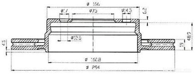

Brand new REAR QH coated vented discs... Listed for my E85 3.0- but don't fit!... (despite every database stating they will!πŸ™„) These are 60mm total depth .. there appear to be 2 depths- these 60mm( measure 37mm from outer disc face to the wheel fitting face - can be measured through wheel without removing anythingπŸ‘)
Been suggested these may fit some 2.0...2.5... and 3.0!πŸ™„

Something very wrong there. The E86 is normally just 325mm! I say normally because the M is probably different!
Oh hang on, the rear is 294mm... are these for the front or rear? Maybe they sent rears by mistake!
These are rears... have updated ad... strangely smaller - but always more expensive than fronts - as they accommodate internal handbrake shoes.
CORRECT!... :D .. the 303's are the ones which have been fitted... 75mm total depth :thumbsup: .. but these BDC5147 are 60mm.
Almost every supplier lists the 60mm discs as fitting the E85 3.0... surprised someone hasn't had an issue before?
That’s very interesting. I’m still on my originals AFAIK although they’ve come up as an advisory now on MOT. Will keep in mind to take plenty of measurements before replacing!
Worth noting that 303’s superseded the 219/ 137. So they should be a direct replacement :| :?
