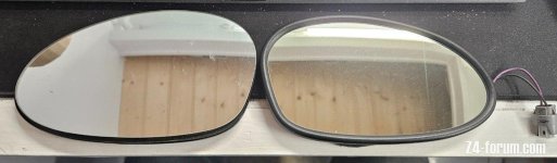

Sounds like you have auto dimming glass.
Does your mirror look like the one on the left or right?
the one on the right. It has a rubber trim around it. Didn't know they did an auto dim one. Never noticed it on this car. It is a 2005 E85 soft top.
Passenger side mirror with auto dim is Part Number 51167177125
Don't look at eBay! I did and nearly fell off my chair!!
New is far too expensive (£300ish) and second hand is hard to find in good condition but around £100.
You can replace it with normal glass but you'll need the heat pad if you want heated glass still. The heat pads are quite expensive new but come with the glass but they are £87 to £113 for genuine.
Part number: 51167112583 for wide angle & 51167112585 for flat.
You can buy aftermarket for around £25 ish with a heat pad but they fit differently by just pushing on. Easier to find by searching for the E81 1 series.
