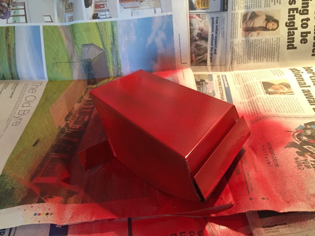

Decided to paint mine red. And think it looks ok. Will try and get it fitted tomorrow
First coat
A couple more coats and quite pleased. May do more just to build up depth. But the deep red it really nice
Top job - would you like to do mine too :D
Quite like it red! Did you key the surface or paint straight over the black powdercoat?
Look forward to seeing it fitted.
Marlon - really easy job to do mate. If you fancy couple hundred miles round trip then pop in :)
Ben - Marlon did ask Dan if it needed priming etc. Dan said it should spray straight on so took the risk and sprayed straight on. Only thing I would say is take your time between coats as prone to cracking if not
