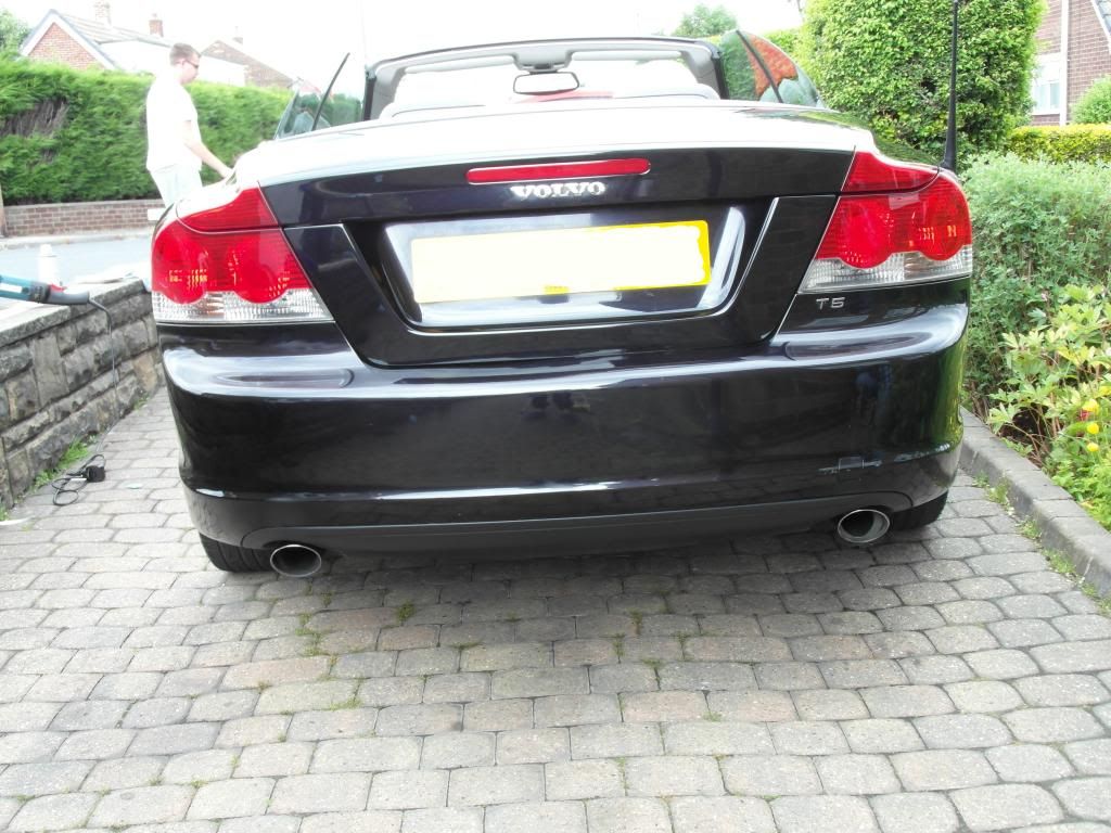

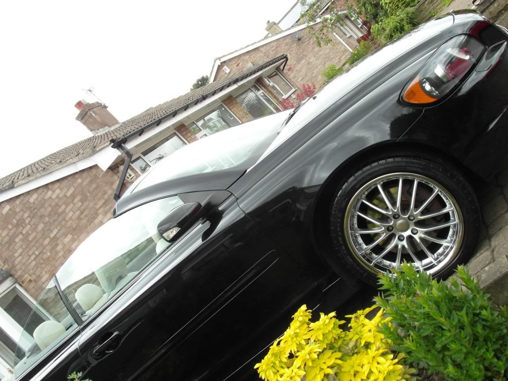

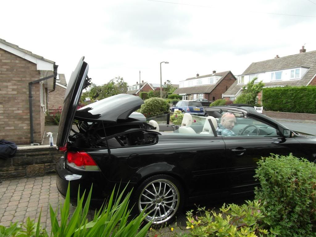

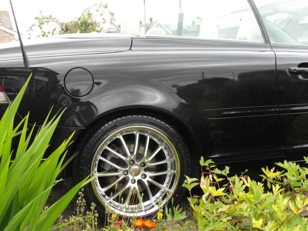

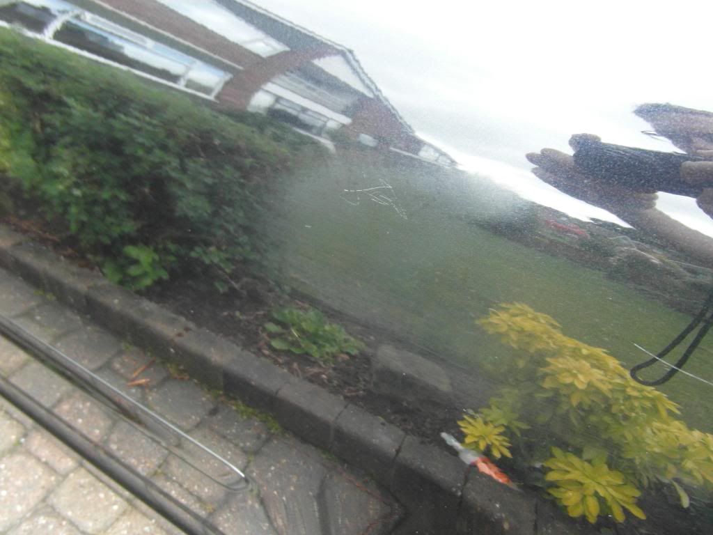

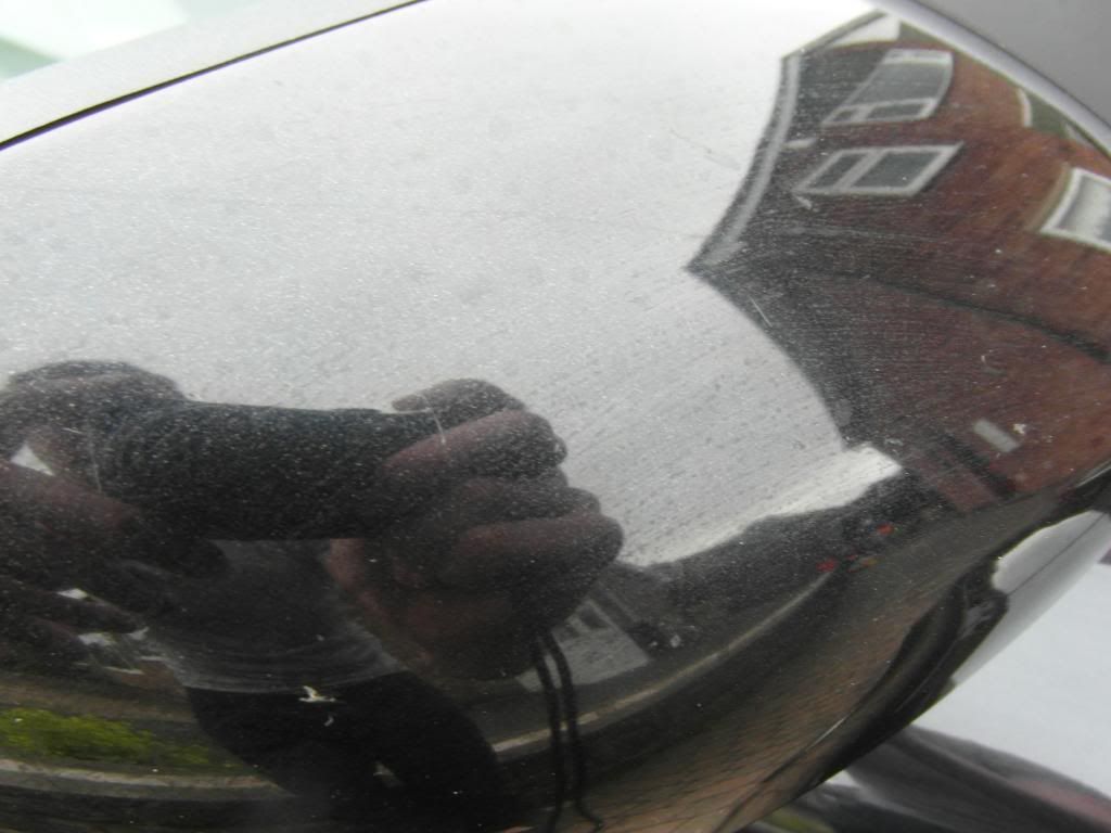

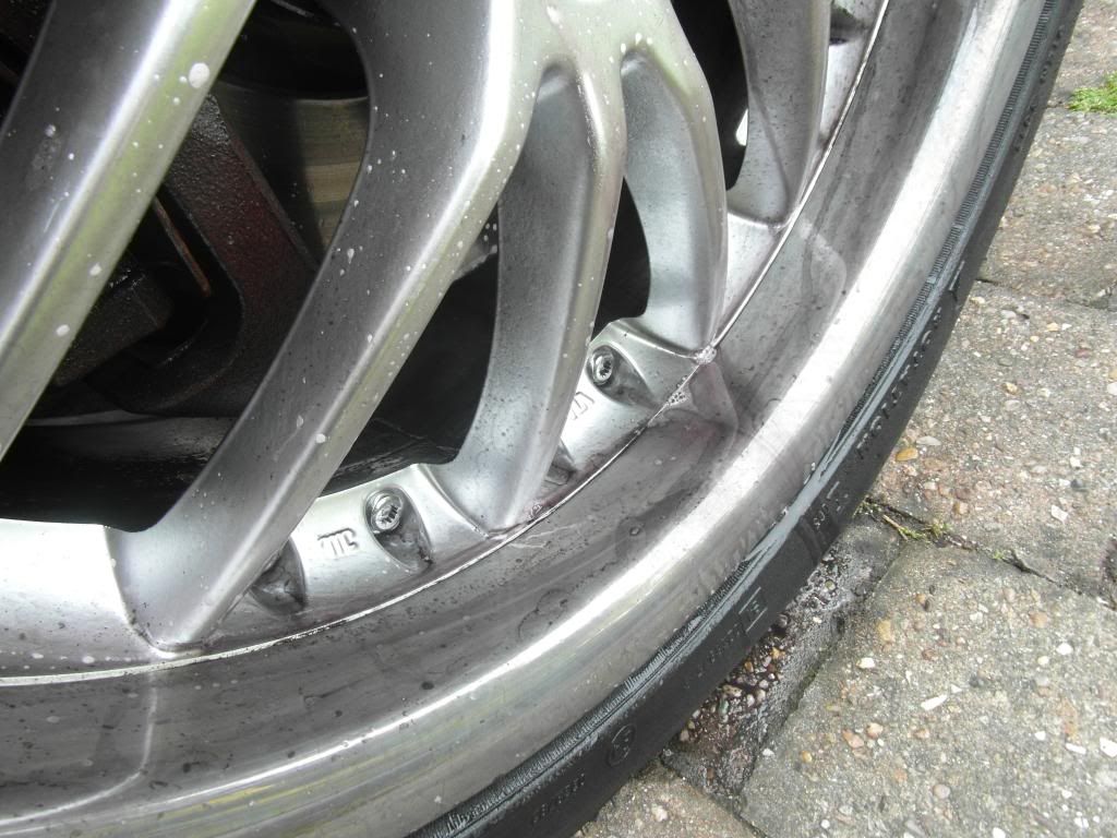

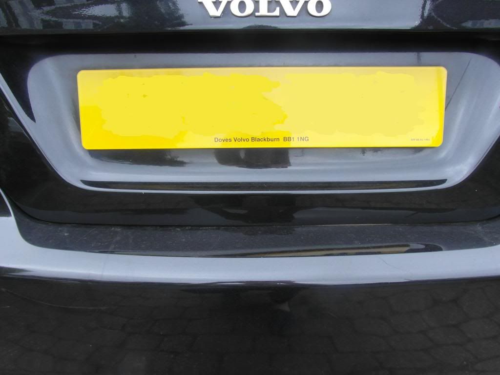

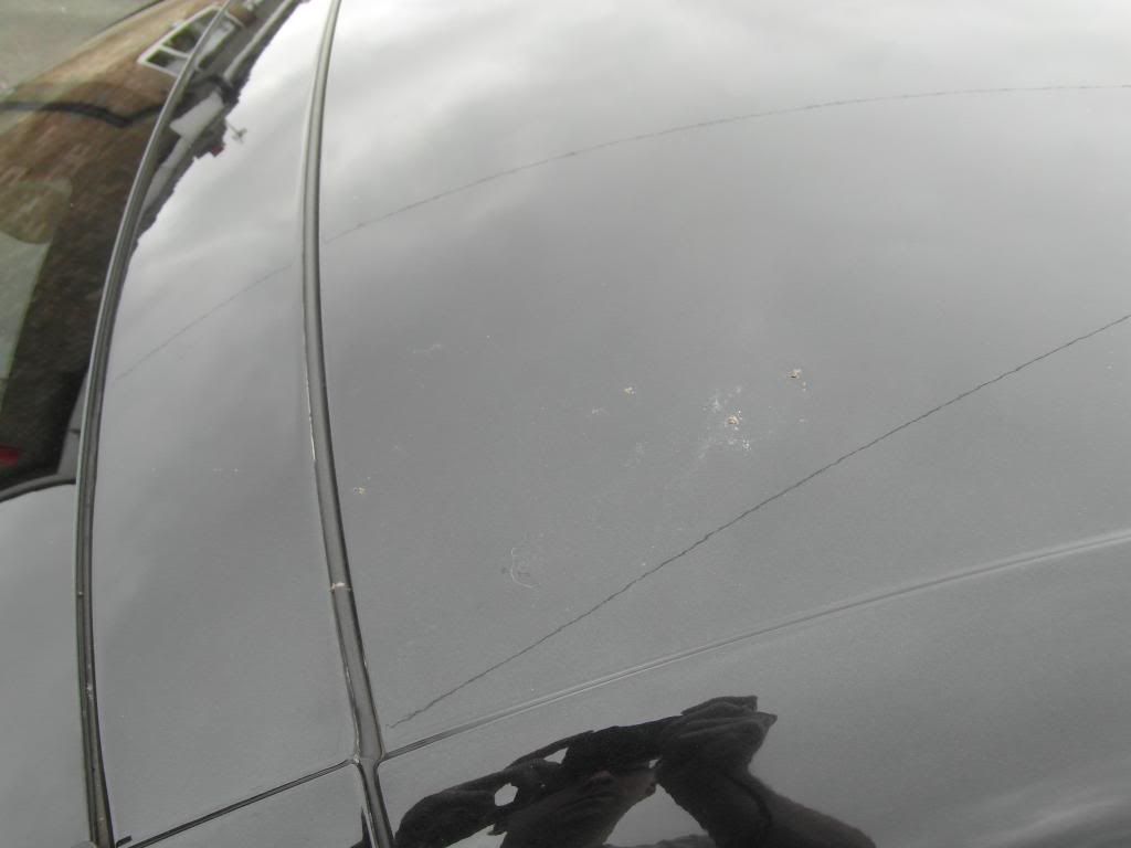

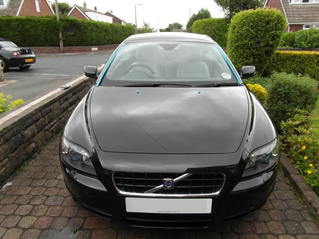

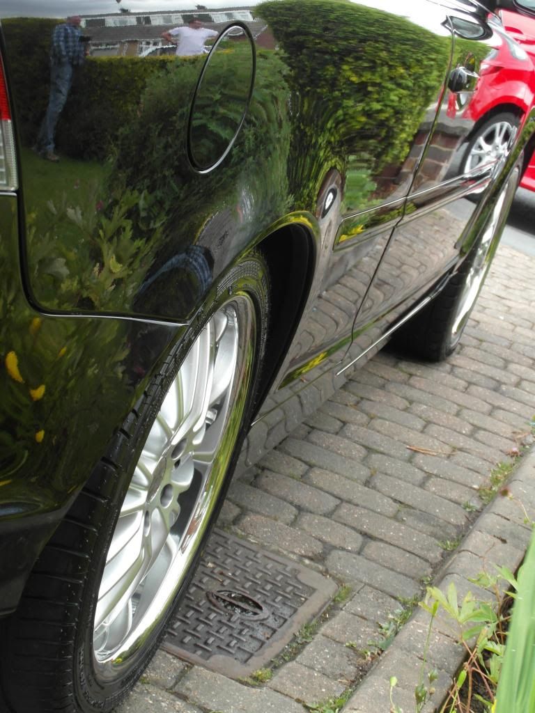

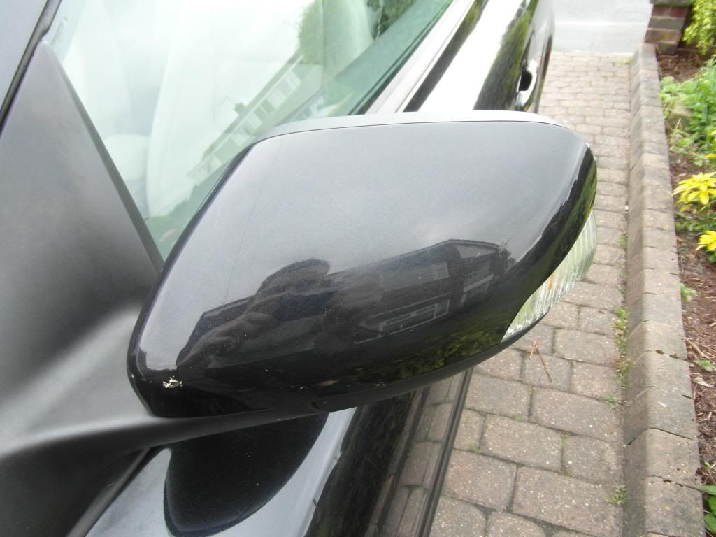

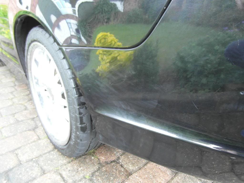

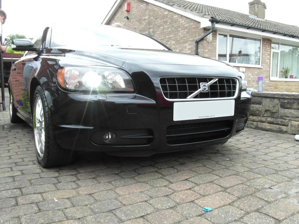

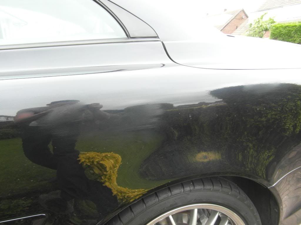

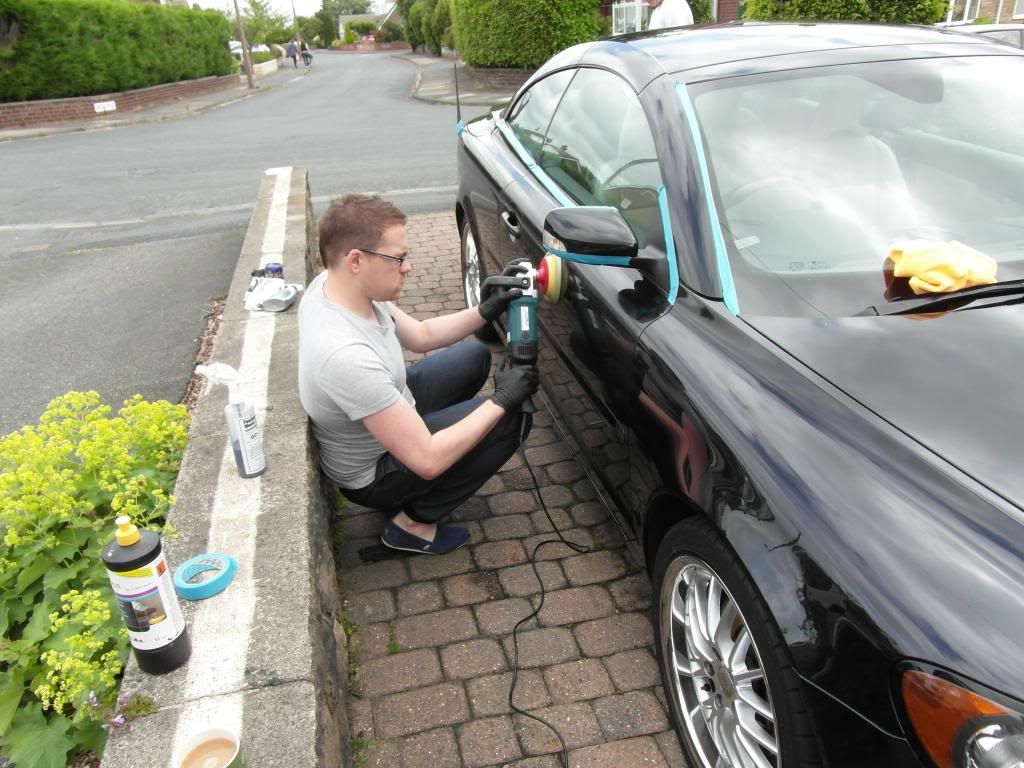

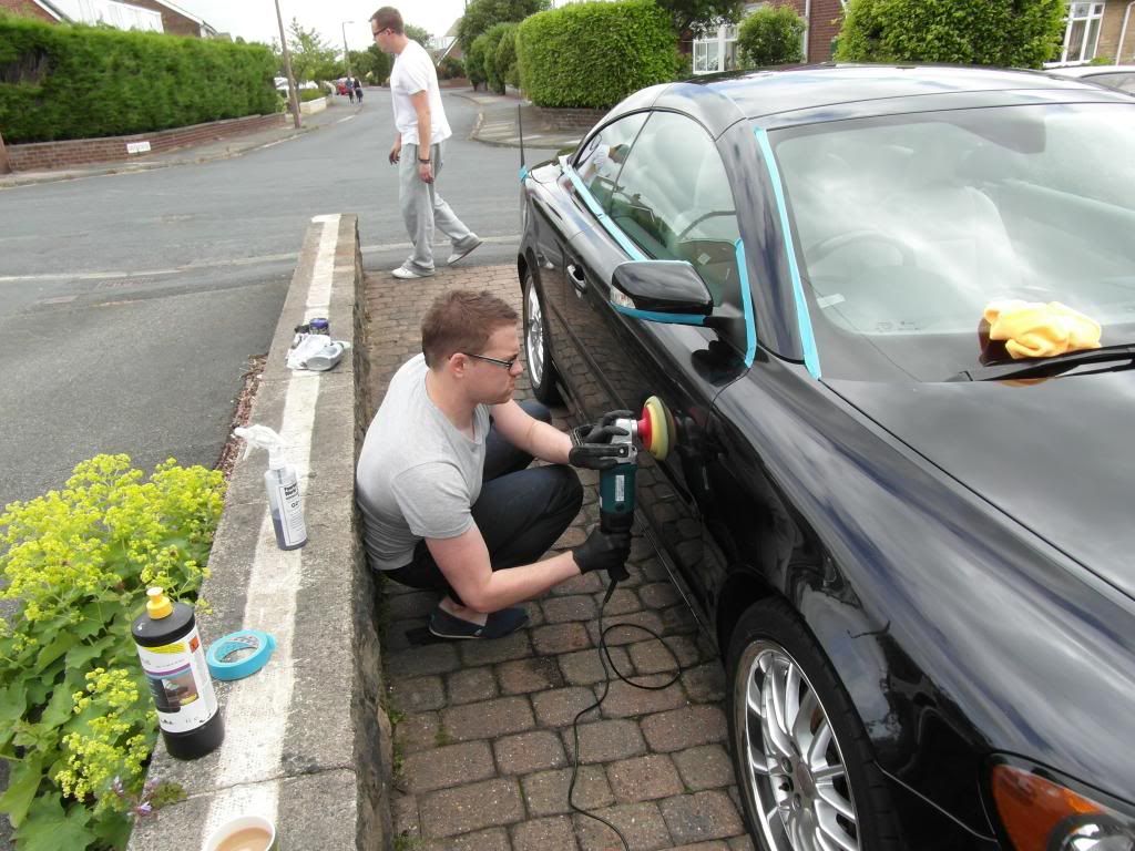

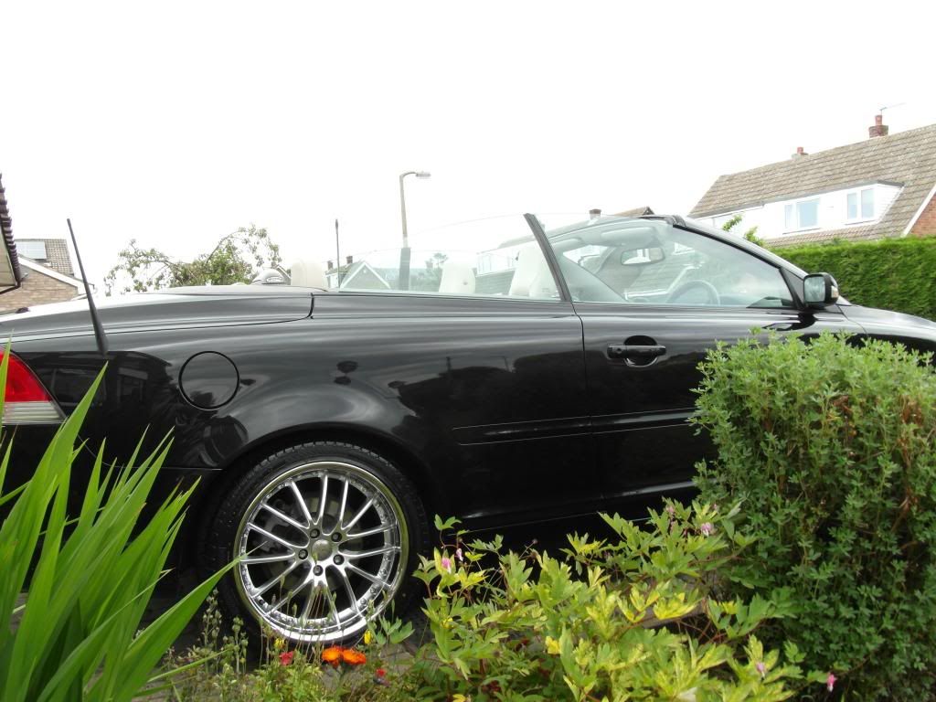

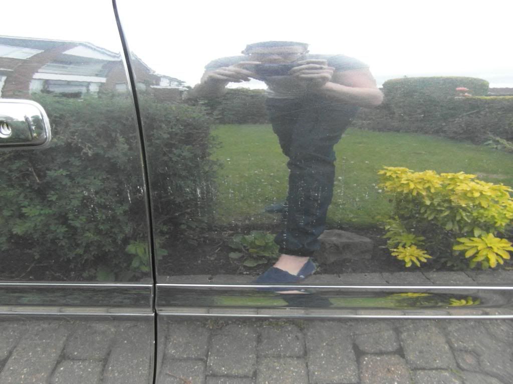

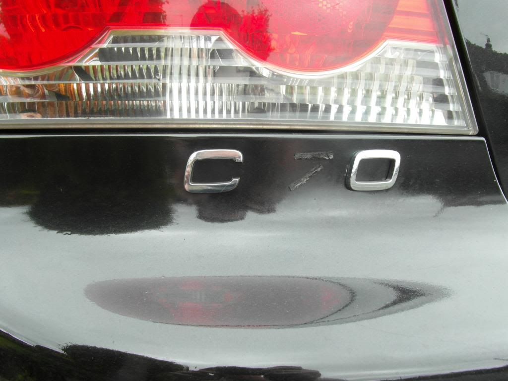

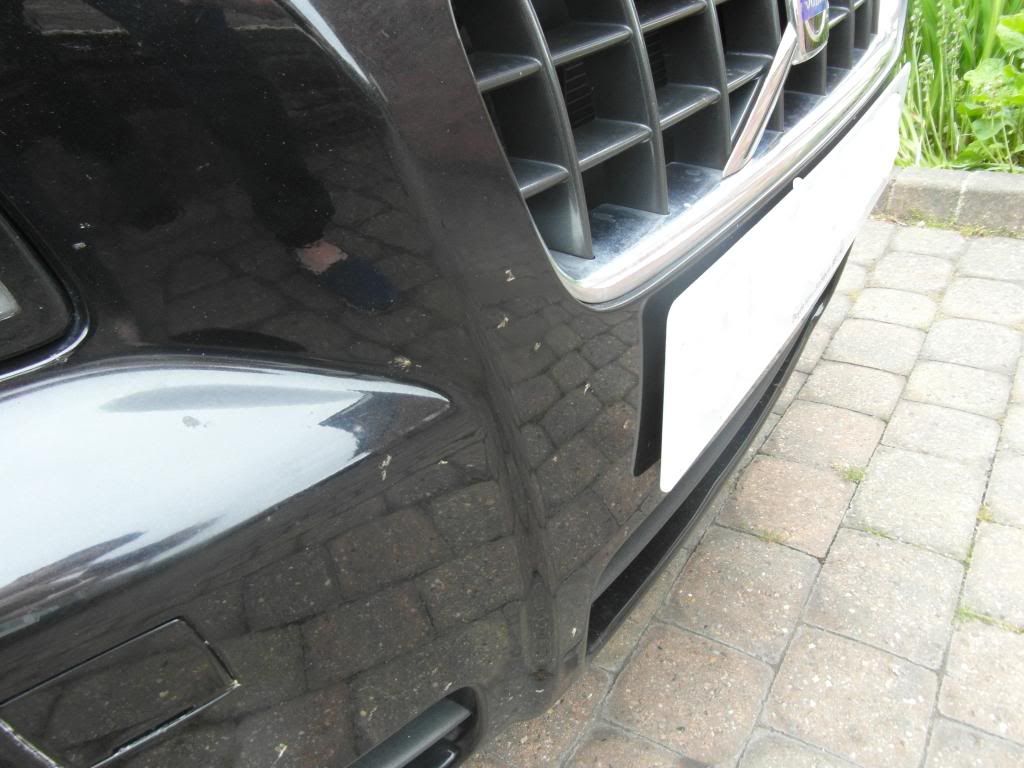

ok so this weekend saw us do a complete correction on this 2006 Volvo C70 T5. This was a new purchase to the owner and the condition was extreamly poor, the whole car was covered in wet sanding marks and scratches! it had also had a very poor respay on the rear bumper!

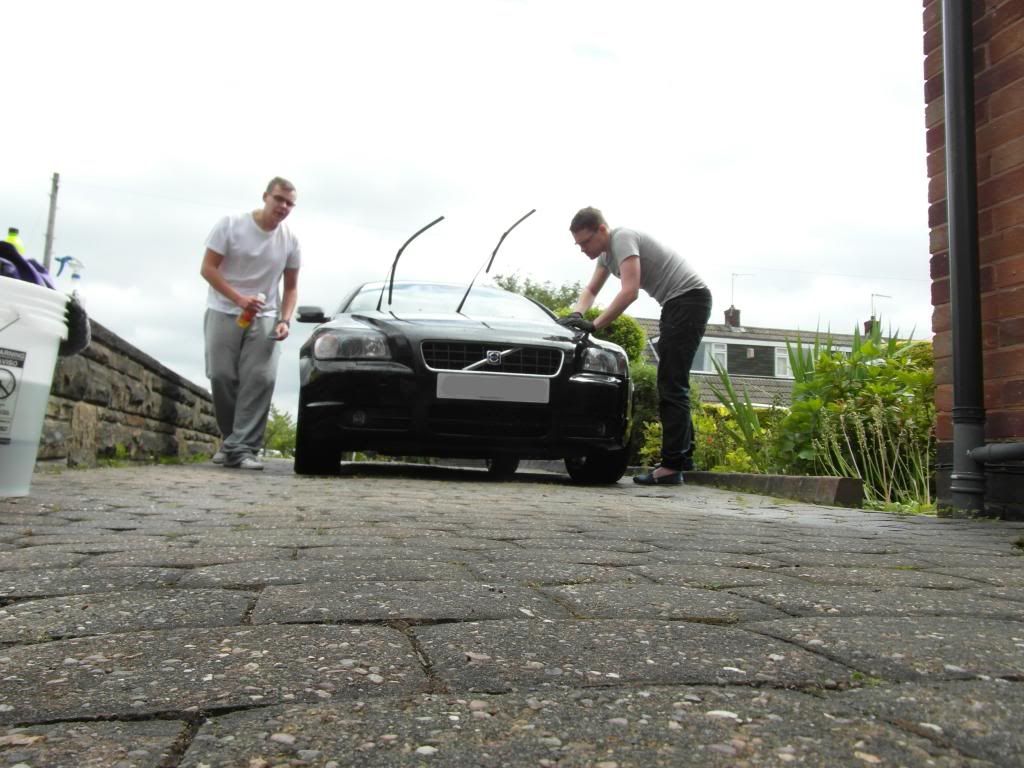

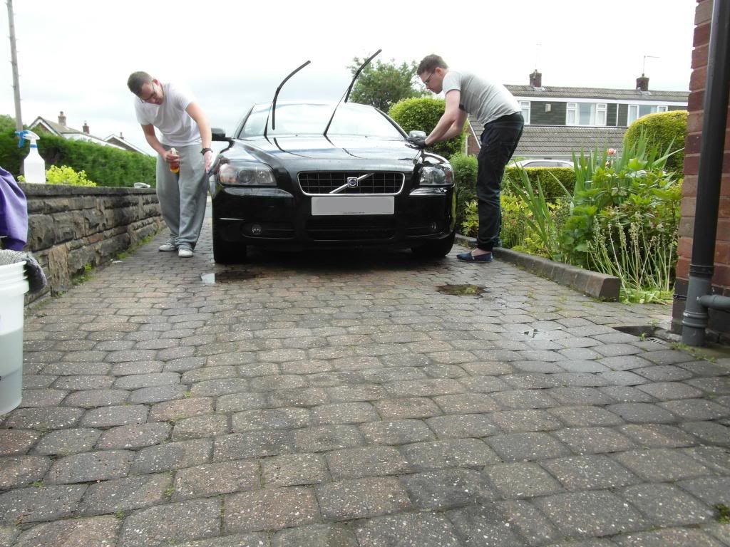

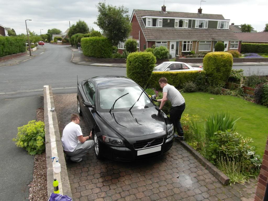

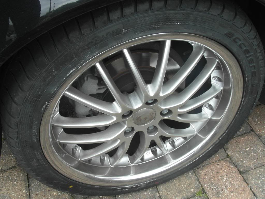

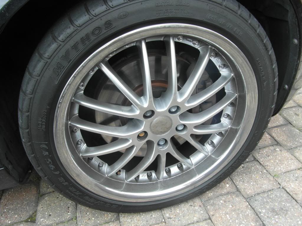

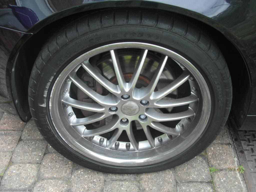

cleaning was taken care of using the 2 bucket method, once washed Tardis was used on all lower edges and wheels. once washed off the car was fully clay bared. wheels where taken care of using several brushes and lots of metal polish

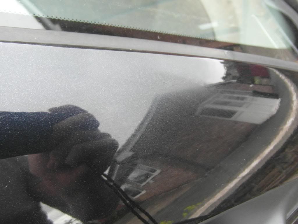

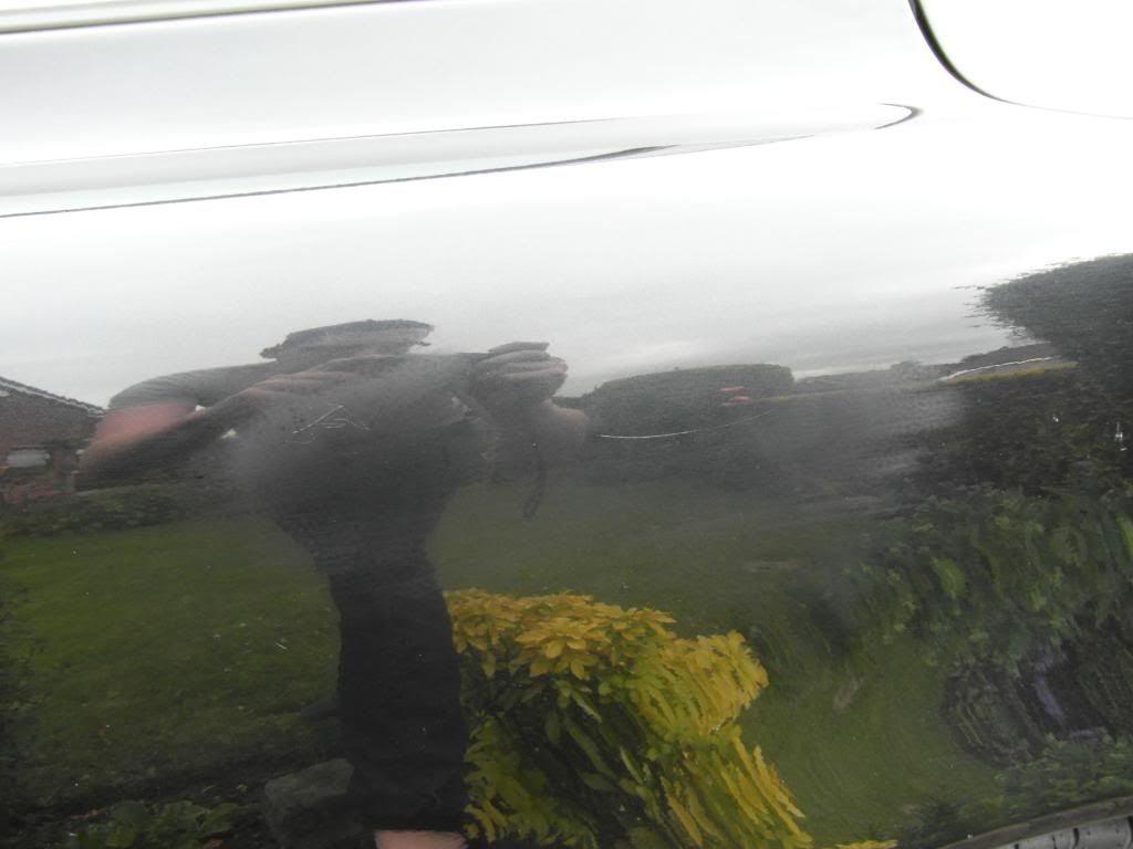

after the clay the car was dried and inspection of the paint done to see which areas to focus on. The polsihing was carried out using 3M polish and pads. the whole car was corrected and then treated to some Poorboys Black Hole and then waxed using Dodo Juice Purple Haze!
anyway onto the pictures

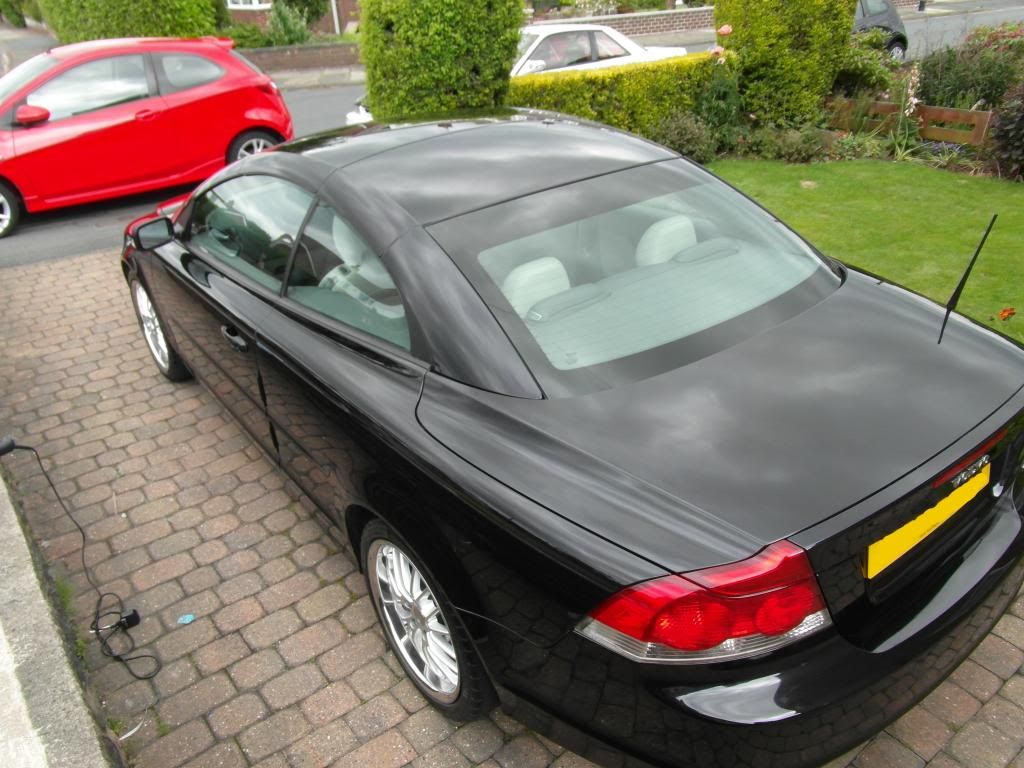

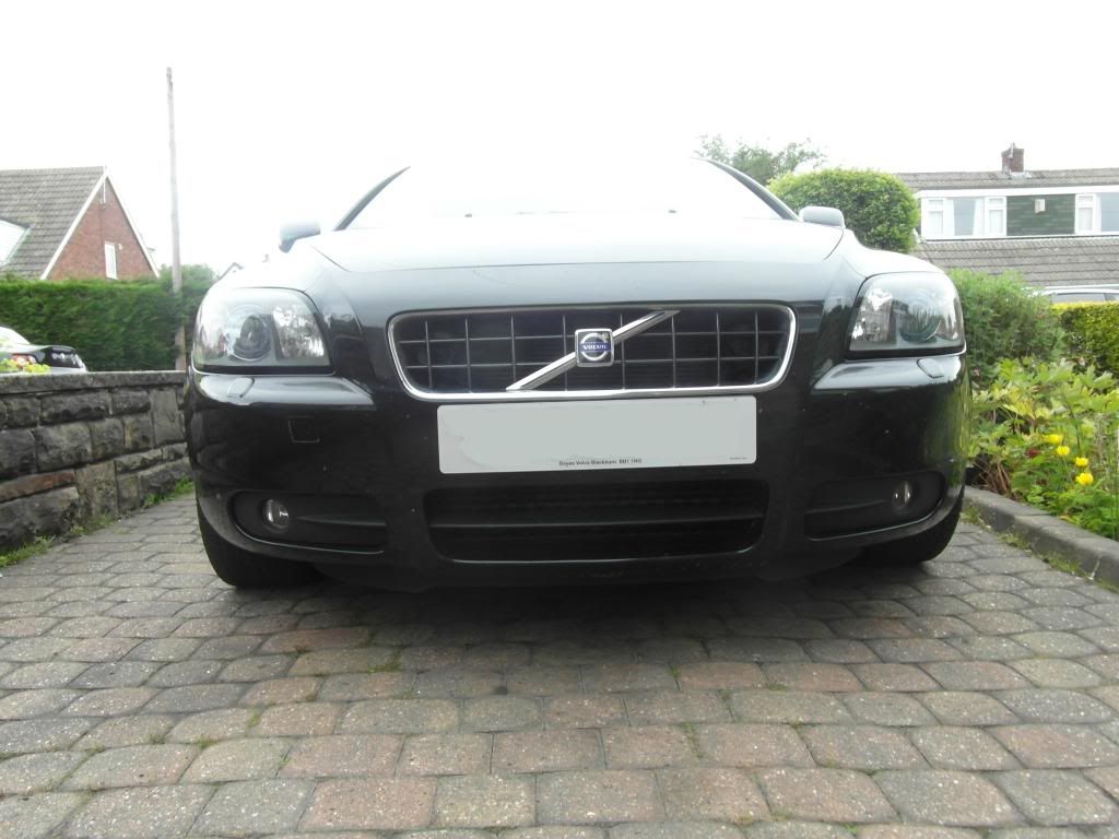

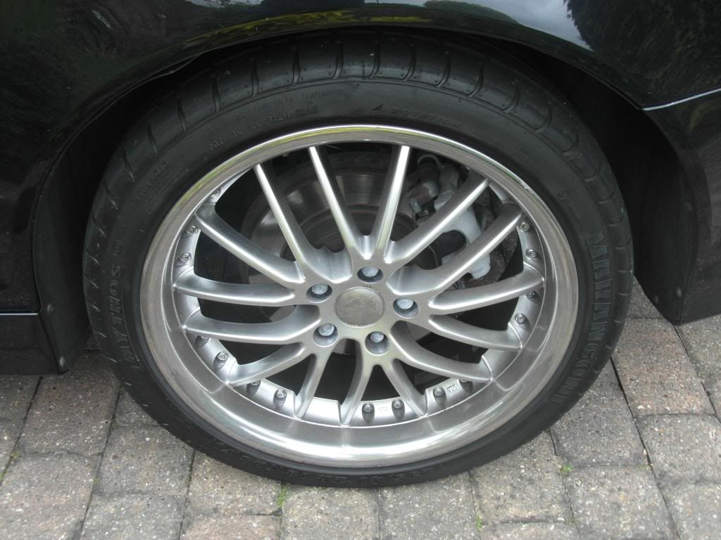

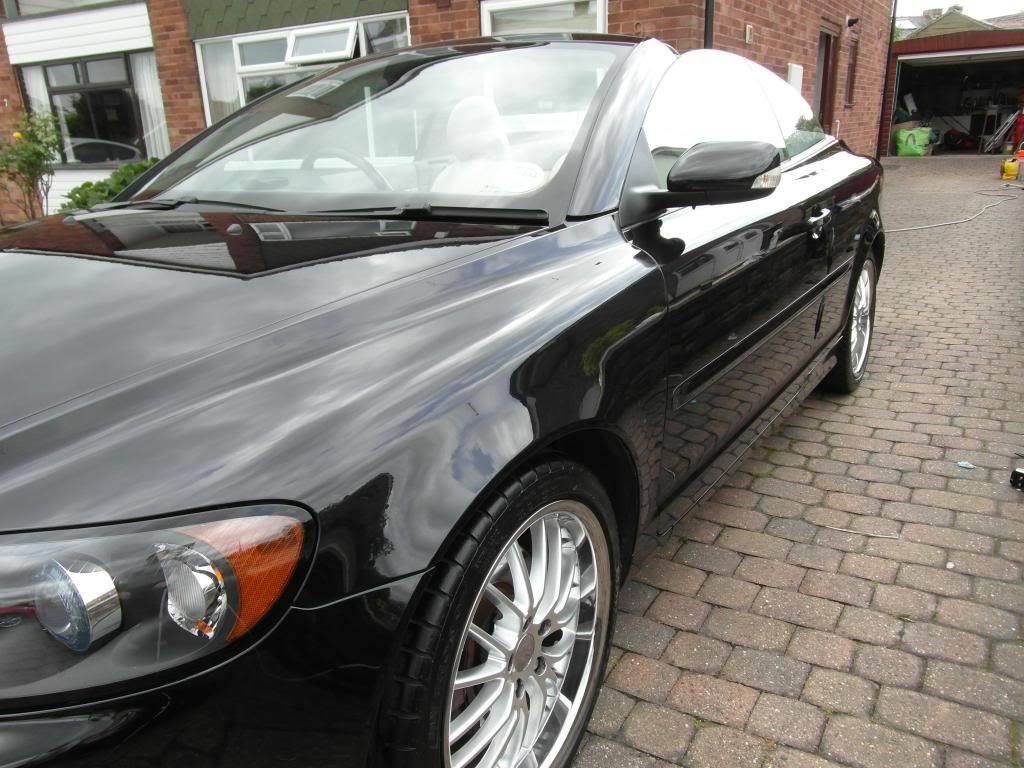

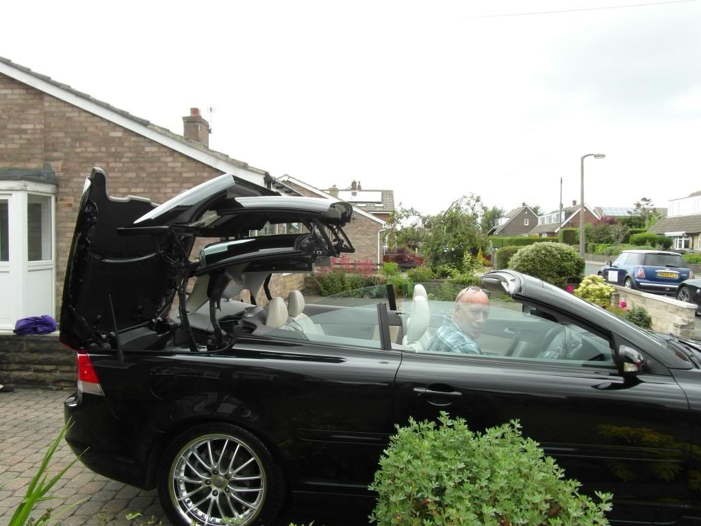

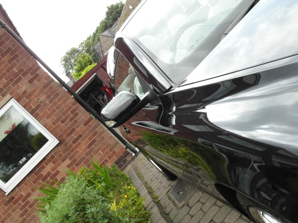

Some Afters!

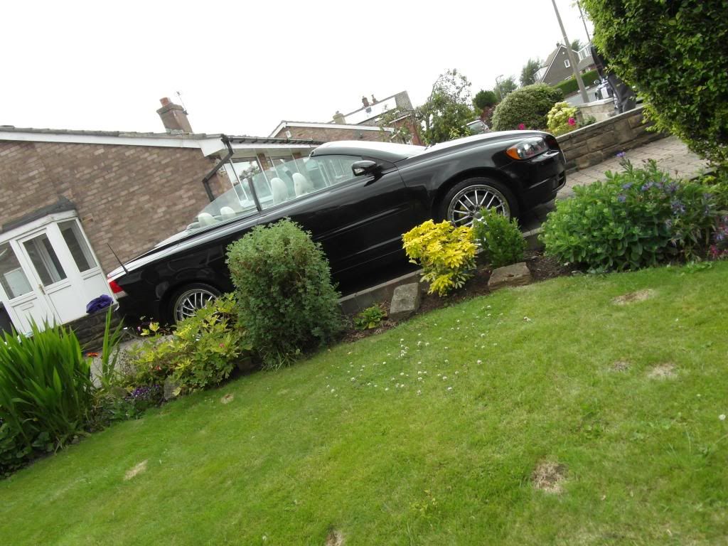

One Happy New Owner
A Few of The Fleet lol

Took about 5 hours in total with 2 people working on it!

only 3M Perfect-it III Extra Fine Compound was used on this job! and the 3M Perfect-it III Polishing Yellow Pad
