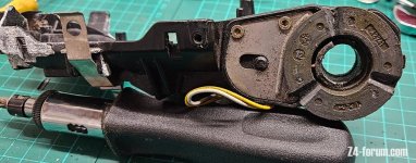

Here is a fix for the drivers side mirror that was getting stuck in the up position.
I took all the rough edges off the ring and re-cut the 3 catching grooves for the pin. I used a dremel with a grinding/cutting bit. A bit like a straight flute for a router
Then I straightened the damage to the actuator housing
I used an M16 bolt with a vice to crush the deformed housing part against the bolt. The thread on the bolt will turn all the way through, the main unthreaded shaft will not pass all the way through so you can tighten up a nut and washer
Applied JB Weld to the damaged areas
After 24hrs I ground down the JB Weld so parts would not foul. I drilled the hole out with a 4.25mm bit
I assembled the actuator housing all back together and applied some grease. Bolted the mirror all back together and did 20 test movements backwards and forwards. Seemed to work very well and stop at the points it should.
Disassembled to take a look inside
JB Weld seems to be okay. Long term may be another matter, will have to see if it's a long term fix or not.
I applied more grease before putting it all back together again.

Here is the mirror unit stripped down
Compared to the Z4 one it looks the same
Audi left, Z4 right

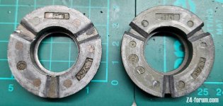

The only difference is the ring, the 3 notches are different and it's about 1mm thinner. It can't be used in its current state.
Z4 Left, Audi Right
I used the actuator housing in the passenger mirror and it now works perfectly. So the Audi A6 C5 unit can be used for replacement parts for the actuator housing, motor, cog, worm gear with Cog and the worm gear on the motor. If you need a ring then it's no good.
