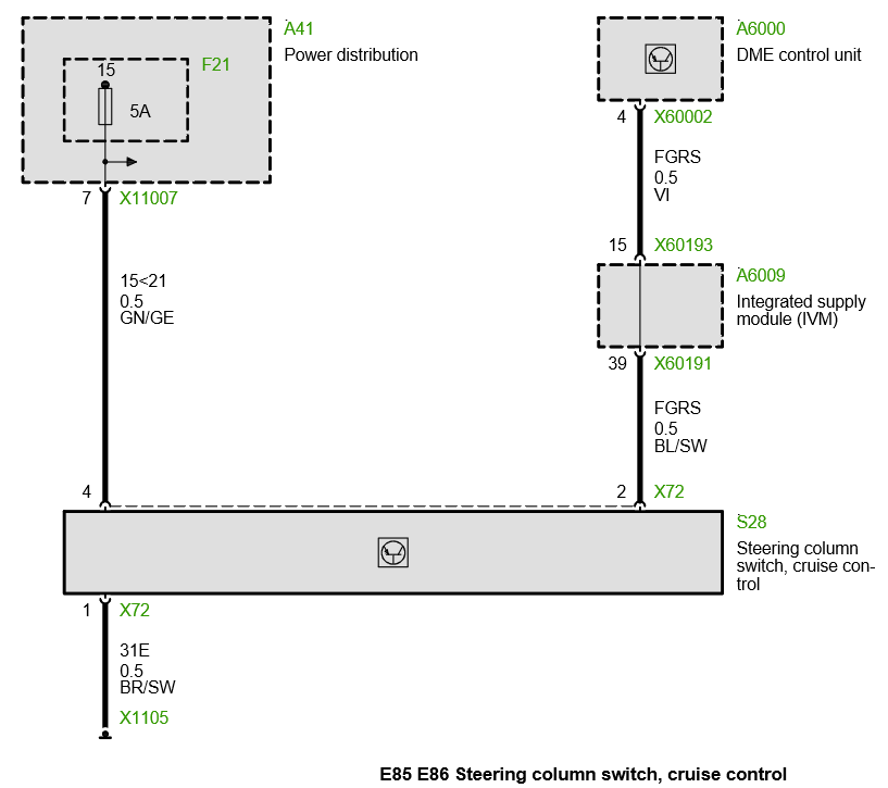

The retro-instructions are wrong for the N52.
The black 'repair' cable needs to be crimped onto the blue cable then put into this block:
Which is pin 39 on the block as shown in this wiring diagram:
Well i managed to work it out in the end and was all done in a few hours yesterday. I was getting very confused about the 'extra' cables that came with the kit. I was expecting that the blue cable from the loom pluged in and then another wire had to be cut and spliced into.
For those considering doing this, its pretty easy. The reason for the extra cables and the heat shrink is due to the connectors at the end them being slightly different to the connetor at the end of the long blue loom cable.
One thing that did confuse me is that the BMW instructions suggest to cut the connector off the end of the long blue loom cable and attach the shorter blue cable to it and heat shrink it for the N52 engine. However this thread and everyones else suggestion is to use the black cable. This black cable did seem to fit into the socket better so i used that.
