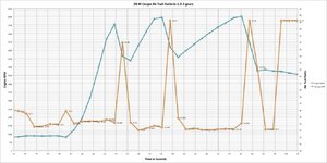

I managed to do some more datalogging of my Z4MC a couple of days ago and this time I did several recordings of various different PIDs (Parameter IDs: i.e. different sensors) in my attempt to understand the Z4MC's ECU operation. Each vehicle (make and model) will only allow access to a specific PIDs and some cars allow access to more PIDs than others, and I've found that the Z4MC allows access to the most of any car I've datalogged.
One of the most useful PIDs that you might be able to access is Air/Fuel Ratio (AFR) and I've never been able to access this PID on any car until I went through the available list on the Z4MC and was delighted to discover that there are 4 AFR PIDs available! Brilliant! So I did a 1-2-3 gear acceleration at full throttle, recording all 4 AFR PIDs and Engine RPM simultaneously. From the data, it appears that the fuelling is controlled by two separate AFR banks, each adjusting fuelling to 3 cylinders. When I graphed them all together, there is too much information all in the same area on the graph to properly see the information, so instead, I used the 2 AFR bank PIDs and calculated the running average (all done by Excel) of the 2 AFRs combined, so that I have just a single plot for the AFR during acceleration, which makes the information more accessible.
The graph of the datalog recording is below. The bit that really stands out to me is the fact that during 1st gear acceleration, the AFR is around 14.3:1, but during 2nd and 3rd gear acceleration the AFR is around 13.2:1. So it appears to me that the ECU has been programmed to restrict fuelling in 1st gear, presumably as a torque limiting method, to prevent wheel spinning, to obtain the optimum traction beyond the skill of the driver. I have noticed that under full throttle in 1st gear, the DSC of the Z4MC doesn't seem to intervene, whereas it will often do in my Z3MC, so I think that this would seem to confirm my observation. At some point, I will see if the DSC (off) or Sport Mode (on) affect 1st gear fuelling.
