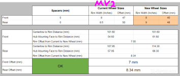

Inkey is bang on with the offset values.
Here is the comparison to my MV2s:
I was planning to put on 15mm front spacers and 20mm rear spacers. To achieve the same you would require 8mm front spacers and 12mm rear spacers.

so after messing around with clearances and fitments i might be able to help a bit, it made it easier for me to understand by working out the equivalents so et48 on a 9j would be the equivalent of et42 on an 8.5j so about 8mm more poke than stock (et50 on an mv2) fronts will be 7mm further out (et47 on mv2) i think you commented on a previous post you were going for a flush fitment mine is pretty flush (i haven't done enough mileage to confidently say they 100% do not rub but no signs at all so far!)
so for that setup obviously depending on tyres too the same flush fit as mine (equivalent et32 front and et 29 rear) you would be looking 8mm spacer front and 12mm rear, that's to get the rims pretty flush as i say ride height and tyre dependent for clearance
