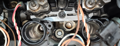

I only found out when initial start was unstable, turned out one plug hole full of oil.
Fitted new cam cover, problem solved.
I assume the cover bows as no4 had oil leak.
Could the oil have come from elsewhere? I had almost identical and the gasket that came out was good as new. I suspect a spillage had come from elsewhere... perhaps loose or no longer sealed oil filler cap. They did replace the cap at the same time, which I found odd.
Is most of the oil in the plug well for cylinder 3, by any chance?
That's a good callout, and I initially thought that it was just a messy oil change. In the picture, #1 is on the bottom, so there's oil in 2,3,6. (or #2 and #3 were so dirty that they fouled my socket... but that wouldn't explain #4 and #5 being cleaner.) In the big picture, a VCG is only $42 USD, so replacing is worth the peace of mind, and I'll clean it up to ensure any new oil is more indicative.

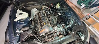

While I'm down there... anything else that I should replace on the N54 since it will take me 30+ minutes to disassemble? When you get into these things you learn a bit more about the previous owner's maintenance... like -- why am I missing 2 of the cover screws of the beauty cover, etc. I'd love to change out the injectors to index-12, but damn they are expensive -- need to plan that for next budget season.
Watched a video that referenced the crankcase vent hose as a possible leak source if there's oil on top of the plugs like that, but not weeping from the outside edge. Will look into replacing that o-ring on #9 as well.
If you're doing it yourself and only paying for parts then you might as well go for it. Like you say, piece of mind. I think with mine the oil was mostly in 3 and, to a lesser extent, 2.

Since getting the Valve cover off was significantly more difficult that I expected, I thought someone had used RTV silicone on it. I pounded, pried, prayed, and profusely pondered how to get the thing off... It was persistence that paid the price.
But we're back together with a new VCG, plugs, endor coils, CVH and PCV, and some replacement vacuum hosts for the casualties of the effort.
I am getting a yellow clock indicator with 00:00:00 underneath, which I think is a service indicator, hopefully unrelated.
BTW, dropping a bolt in this bay is a right PITA. Luckily my 13 yr old 's skinny arms and an endoscope was able to recover it...
