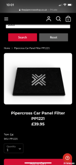

Just curious had anybody changed their filter for a pipercross one? If so did it make any difference to the sound or not?

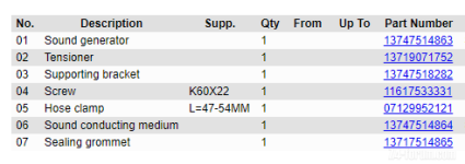

I looked into this for wifey's 2.5i and the general consensus seemed not to bother. The possible issues outweighed the very minor sound benefits.
I ended up sourcing all the parts needed to fit the sound generator, then popped out one of the foam pieces.
Wifey is very happy with the result.

thanks for the reply, that sounds interesting when you get chance can you tell me what things I need to look for to do this please as mines the 2.5 also so would look to do that then :thumbsup:
OK, so firstly, if you search on Realoem you have to look at the 3.0i as that had it fitted as standard.
It won't be cheap, unless you have the patience to wait and pick up bits as you go.
You will also need to change the big inlet elbow to one that has the extra pipes coming off it.
You need Item 5.
There are quite a few helpful threads on the forum about changing this over, but to be honest it's not too difficult to do.
I seem to remember there was a bit of jiggling about with the elbow connection to the hose from the MAF, as they are slightly different, but laying it all out on a bench makes it obvious what needs doing.

I think I'm right in saying that the OP has an M54 engine. The sound generator is a completely different size and shape.
Whether it could be adapted to fit I have no idea, but it would be an expensive experiment.

M54 and N52 sound generators are different - make sure you get the right one :-)

Have I missed the point here. I believe the question was about the Pipercross panel air filter which is sold as a performance filter as opposed to the stock paper one. I also have the 2.5 and did a lot of research into this.
All recommendations were to stay clear of the K&N filter as reoiling the filter after cleaning could lead to oil getting into the intake and playing havoc with the MAF. The pipercross filter uses different levels of foam bonded together and avoids this. I did purchase one last year and was impressed with the quality. Although it is subjective car did seem to pull away smoother and with more punch through the gears as it breathes easier and with less restriction than the paper filter.
Also it didnt make much difference to engine noise so I recommend it completely.
