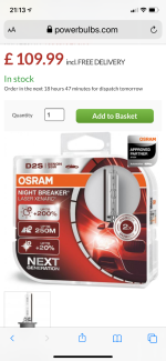

This is the correct one yes? £200 for bulbs is annoying.

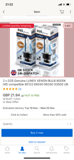

I bought these -
https://rover.ebay.com/rover/0/0/0?mpre=https%3A%2F%2Fwww.ebay.co.uk%2Fulk%2Fitm%2F283303518958

Think that’s a twin pack....
Be careful buying from eBay as there are LOADS of fake Osram/Phillips bulbs around.
Also make sure you don’t go too high on the colour temp, no more than 6000k if you want to avoid everyone accusing you of being a chav.

Ordered from Powerbulbs today. About a million times cheaper than eurocarparts!
