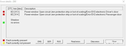

Can't get ONE TOUCH windows UP to work on my E85. I get this error message using Scanner 1.4:
I think that, because the jam protection is not working, setting the ONE TOUCH function is not available. When I try to clear those error codes, the software will not do it. So I don't know if it is a hardware issue in the car (sensors are not working) or if there is something else.
