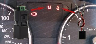

I put one of these in and all is good

Thanks Zoomer! I'm hoping my mate with Carly will remember to bring it in to work on Thursday so I can be absolutely sure of the issue, but that certainly looks to do the trick, and based on a quick google the image below appears to confirm it deals with the correct fault light I have coming up!
