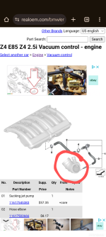

I've gone to check it this morning, and it is indeed stuck solid. However, I also noticed a tear in the tubing. I need to replace the part but cannot for the life of me find the part number. I think I got close on realoem, but the part is shown on the diagram but not numbered.
Does anyone have any ideas on which part I may need?

https://www.realoem.com/bmw/enUS/showparts?id=BT32-EUR-06-2003-E85-BMW-Z4_25i&diagId=13_0995
Intake boot is in Fuel preparation section on real OEM
