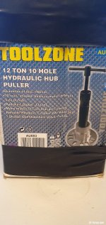

I took both of my driveshafts out last year as part of the rear end rebuild. One tapped out of the hub splines quite easily. The other would not move however big the hammer and I was starting to damage the end of it. Tried making a bigger puller / pusher tool but in the end got one of these. Even then it was a struggle and it made a nasty grating / creaking noise as it eventually moved. Well greased when it went back in...
