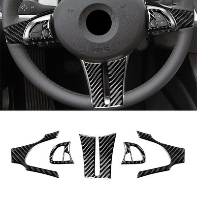

I was trying to get a set of the rubberised plastic parts, whose coating starts to break down. I was going to try to make some templates for members to download and to be able use on vinyl / decal material of their choice so that they could apply it themselves without the whole process of removing the steering wheel and stripping it down. This way we could do matt black, gloss black, silver...... whatever colour you can get the decal in.
The alternative was to get a set of the decals below and try to make templates from them but they don't seem to have the best coverage...
