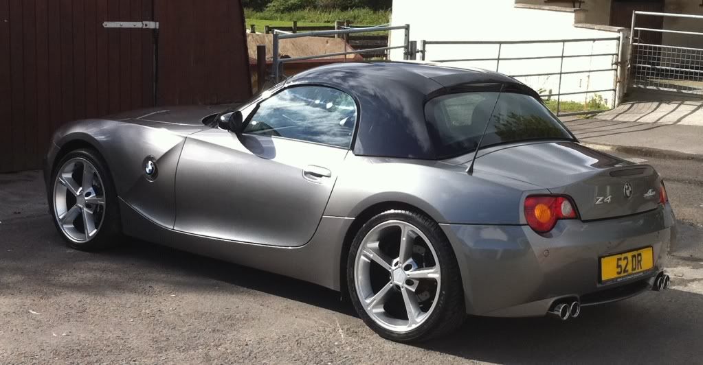

Well I've finally had it done.
My Quad exhaust conversion has been carried out the Stainless Exhaust Specialist Ranski found in Mansfield.
Here's a couple of quick pics that I have been getting pestered for already.
The RH box has shifted a bit on the 200+ top down in the sun journey home, saw only one other Zed and E89 with the roof up on the A1, shame on whoever it was.
So in the end I went with some slightly staggered slash cut tips.
I'll try and get some better pictures later if you lot demand them :poke:
Looks very neat and really finishes off the aggressive rear of the Z
Wow looks great richard :thumbsup:
