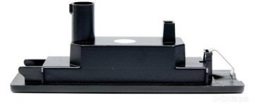

Hate to regurgitate an old post! But the pictures are missing. I have a dodgy clip that I need to reshape again, but not sure what it should look like.
There you go, like we all know, they look nothing like this when you pull them out……
Thanks! I couldn't fathom how they were held in after seeing the mess of the metal upon removal!
Not sure if these style of lights are all the same but the ones I have seen have a slot next to the lens that you put a flat blade screwdriver in and then push it towards the metal clip end. This lets the opposite end drop down without damaging anything.
