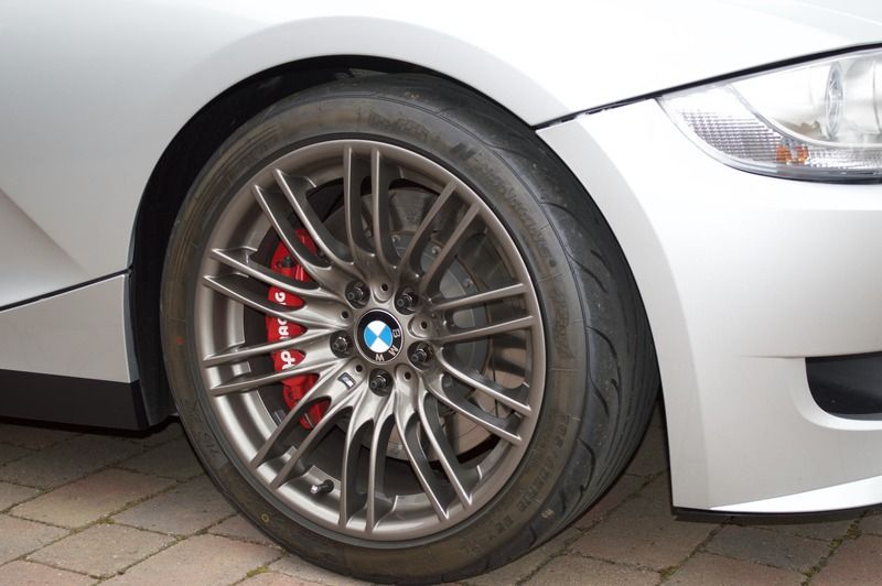

i run the nankang ns2r and tbh... they are awesome, i run the road compound to try and get some usability and they really are fantastic... hard wearing too, grip levels are high enough that you think something is going to break, really progressive to slide and and the steering feel is fantastic with these, i love them!! They are supposed to be pretty decent in the rain too, I've been caught out a couple of times and they haven't felt dangerous, they cost a quarter of a high performance road tyre like PSS but in the dry grip area these wee all over them, sadly they are good for one thing really , track / fast road driving so if you need a more rounded type the PSS is much better in this respect.
They make a racket , like 888s but not as bad, dry grip is some of the best I've ever experienced, can't REALLY comment on the wet performance but they felt OK when I've been caght in a summer shower, they don't like cold weather and will probably send you off in a hedge.
the run WIDE so be careful with your choices, wear is VERY surprising mine have gone more then 10 sprint events now and still have 3.5+mm left, they respond to Neg camber really well to, did notice the tread seemed to turn blue after that last event so I'm wondering if they are going off or have been heat cycled too many times, This season should see them finished off.

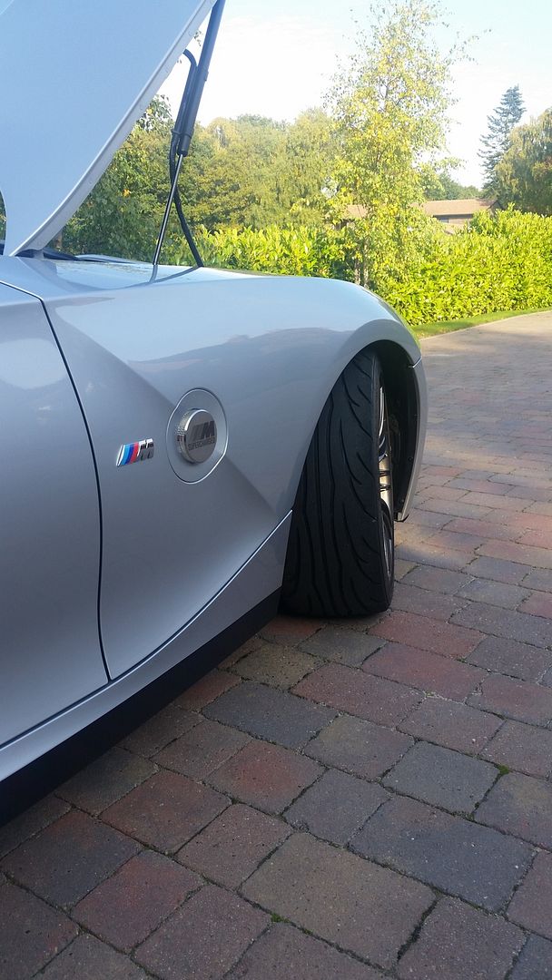

I Can't really advise on them in 19inch but I run them on my mx5 and I wouldn't want to use anything else the only downside as mentioned is that they are very noisy
these are or were the control tyre for a number of actual race championships... Excellent tyre, was alittle worried about the weight of the z4m on these but they shrug it off very well...

So on my OEM ellipsoids Would you suggest going a different size to what i run now? ( 225/40/18 front 255/35/18 i think on rear. Stock sizing )
I don't have that much, I'm on H&R springs and soon to be Koni yellow dampers and it sits pretty low. the tread on the front is pretty much in the arch with a little more ( not much though ) on the rear. I don't have any spacers on. I'm fine with square but definitely couldn't do slight balloon
With the sidewalls being so stiff , you think they would still perform ok being a little smaller width wise?
