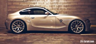

One could say, it's on its arse! Personally I think 19's suit the coupe better than the roadster. Just my own opinion, obviously.
They look too big to be 19’s on that coupe though - I’m sure they’re 20’s but it could also just be due to the 108’s looking more like 17’s than 18’s due to the split rim section
