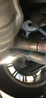

Check under the rear of the car and see if the pipes from the backbox have been cut and fixed again with clamps. This is a tell-tale sign the original box has been cut and replaced
Often cut here and fixed with clamps like these...

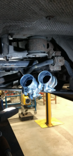

It could also be an aftermarket stainless jobby in which case it'll likely be far too small for the space it sits in

Well, i had a look tonight at the sound generator and it’s got no foam in it. So it seems that may be the culprit.
Can I put in any foam or can I block it off completely?
