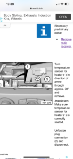

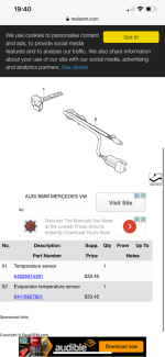

So the other morning on the way to work all I got was cold air from the heater. Engine temperature sitting in the middle as normal. Played around with the heater controls, and after a little playing hot air eventually came on.
Initially I thought this was the dreaded water pump, but no errors recorded (checked with Carly).
Coolant levels fine.
This happened once before about a year ago and came back by rotating the temp dial min-to-max.
Any thoughts? Sounds electric to me.
Car is on 120k, I've not changed the battery nor the water pump since I bought the car at 60k, 7 years ago.
