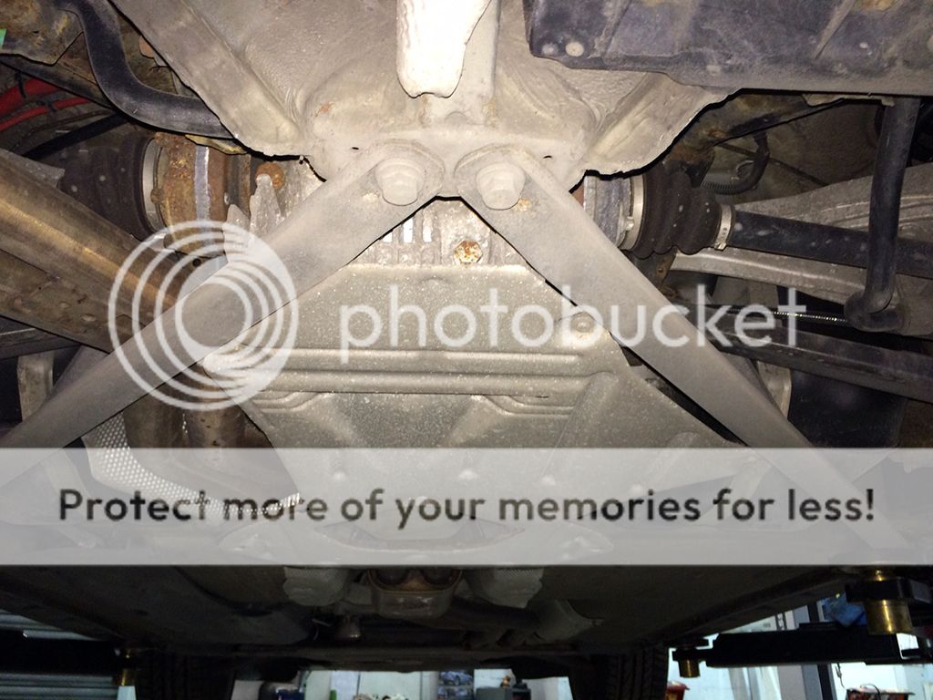

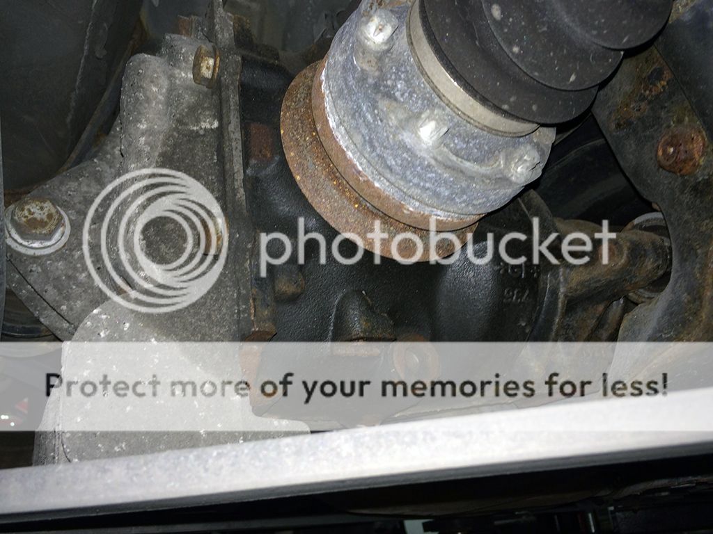

For the first part of this job, the Heatshield/Undertray protecting the diff needs to be removed to give you access to the Drain and Fill Plugs:

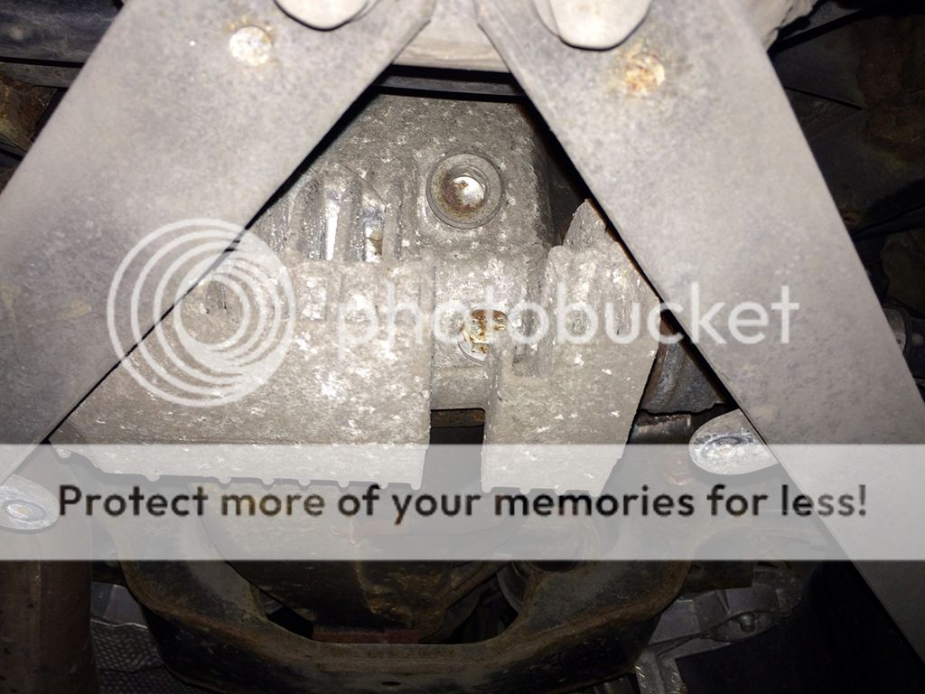

Next up, You need to located the fill plug, and make sure that comes out cleanly! If it doesn't come out, then stop what you're doing and do not drain the oil!

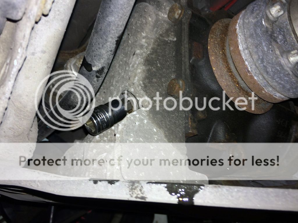

Once you have confirmed the fill plug comes out nicely, you can now locate the drain plug and eject the original diff oil! The Drain plug is just below the right hand inner CV Joint.

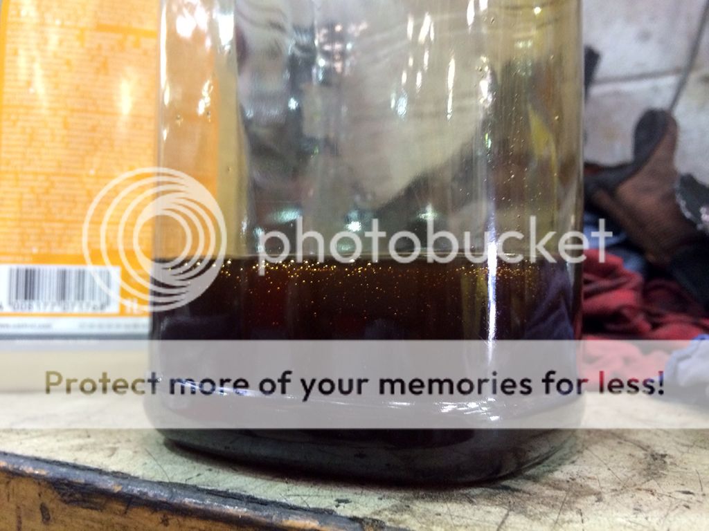

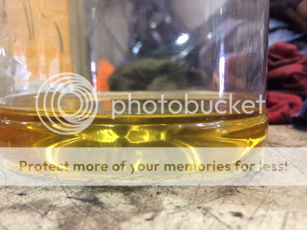

Here's a quick snap of a Sample of the fresh diff oil.
And now for a quick snap of the Sample of the old diff oil. I'm happy with how it's come out! Have seen this stuff much much blacker, so this shade of Cola was good news to see! Not bad at all for 75,000 miles!

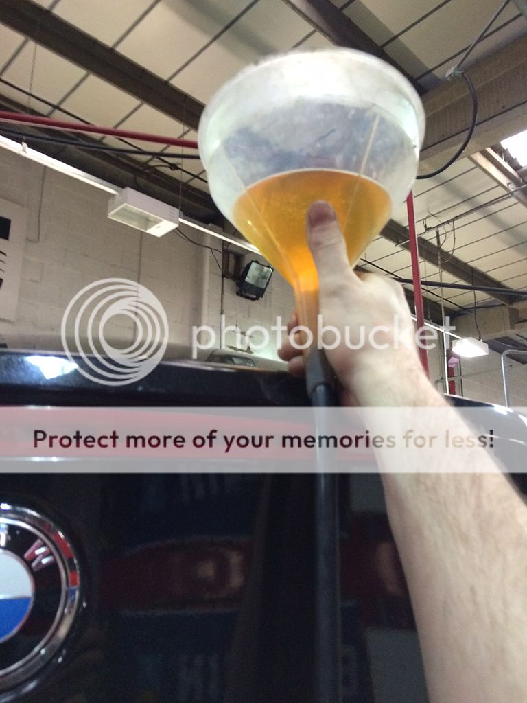

As I'd lost my gearbox oil filling tool, I had to rig up a temporary filling device! This came in the way of a 18mm Silicone hose and a funnel to fashion a gravity feed

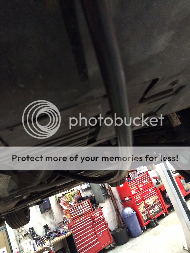

The hose needs to be inserted by around 1-2 inches to properly fill the diff.
Once in position, the funnel will need holding up high and the first litre of the oil pouring into said funnel.
This bit takes a while and you'll probably need to swap hands a few times.
Once the first litre is in, Get a spotter under neath the car and pour in another 250ml.
Once the spotter sees the oil coming out of the fill plug, that's when you're full! Get the pipe out, and pop the fill plug back in!
That's it! Done :)

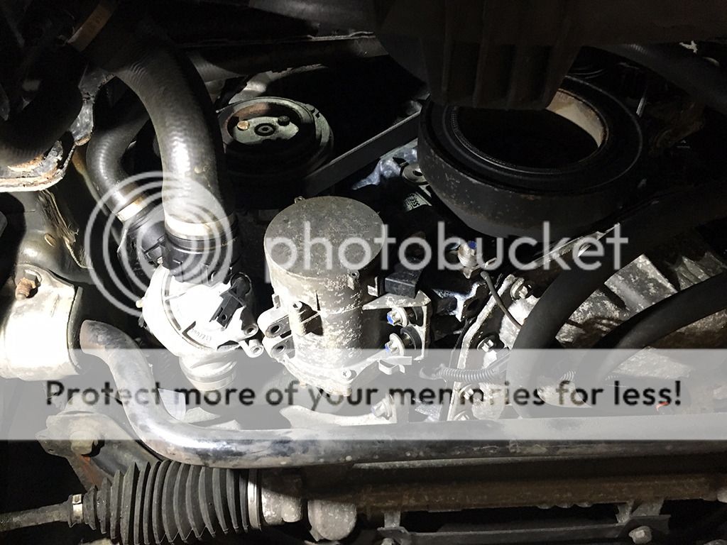

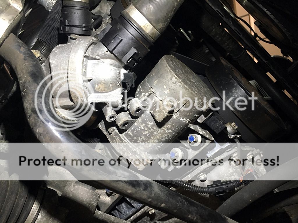

Managed to get an evening in the workshop tonight to went ahead and sorted out the thermostat and waterpump :)
Having watched a few different peoples interpretations of how it should be changed on youtube, I set out with a good idea of what to do and a few tips and tricks under my belt.
Much to my surprise, the Z4 is actually a hell of a lot more accommodating than the E9x and the 1-Series models. This pleased me somewhat.
Just look at all that room!

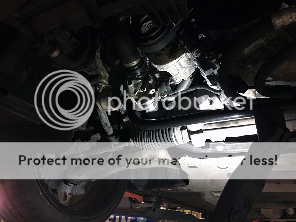

Here's a pic of the pump and thermostat in position - Not sure how, but this one came out looking like a studio shot!
Another view from a different angle - Everything was relatively straight forward, nothing that really challenged me.

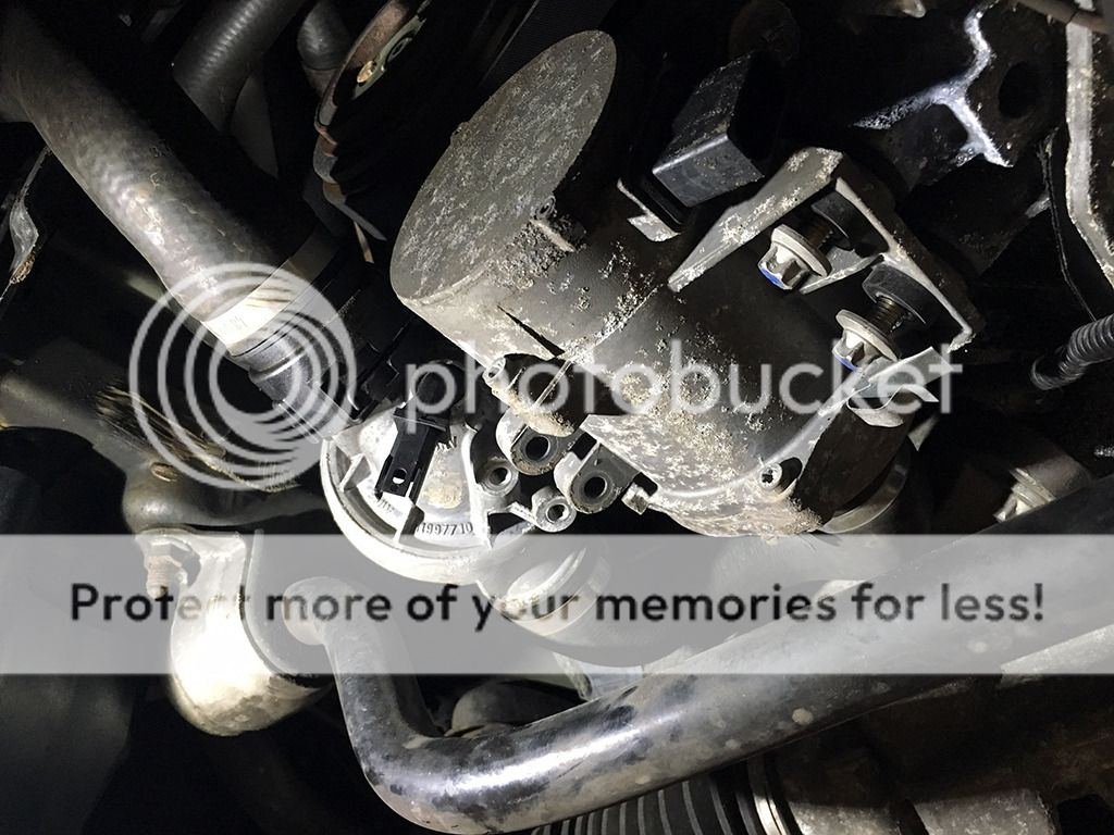

With the pump removed and the majority of the coolant drained, the thermostat was super easy to access

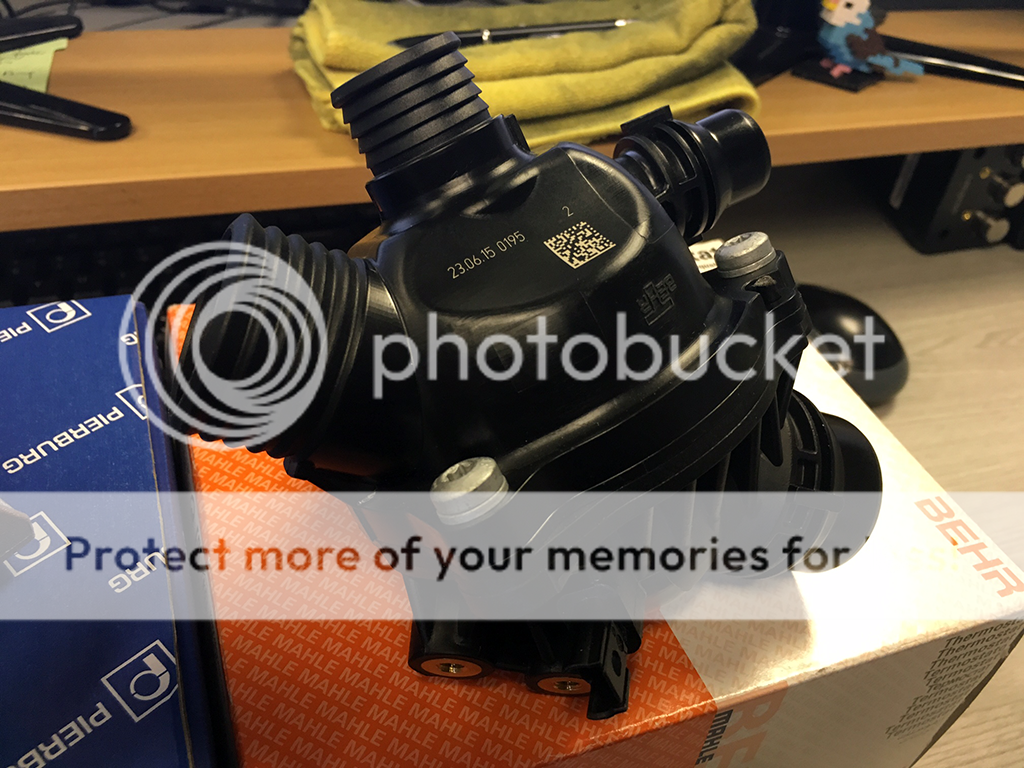

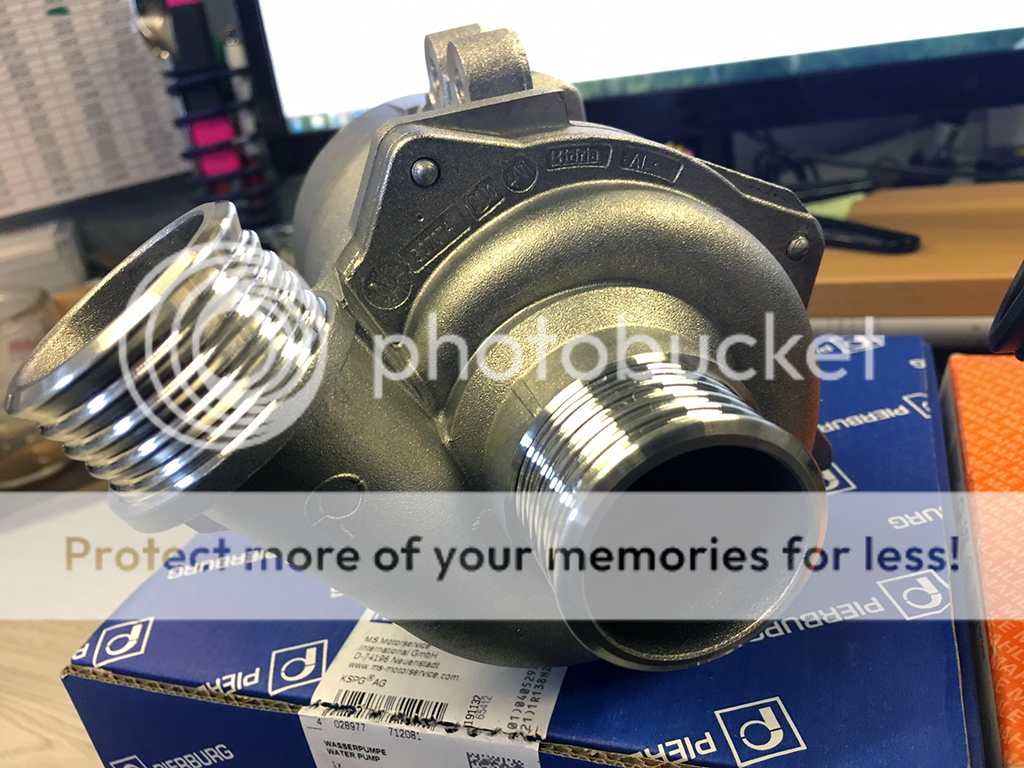

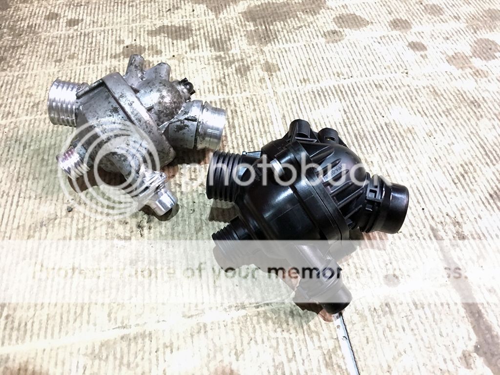

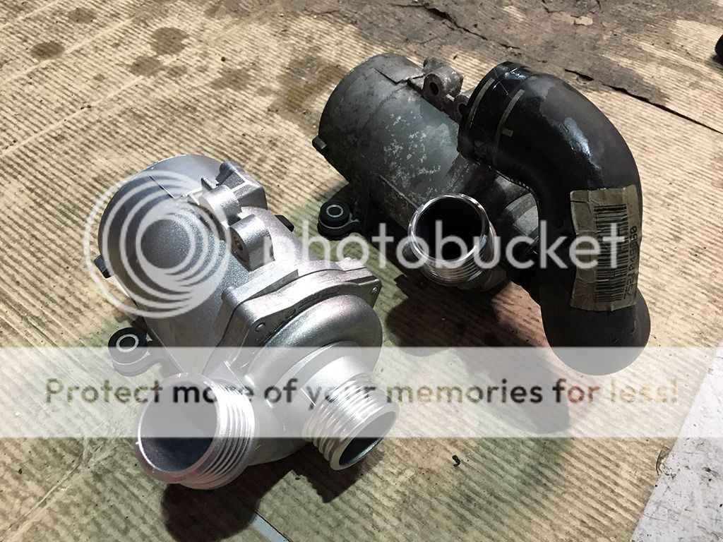

And here's a couple of comparison shots, Firstly Old vs. New Waterpump
and finally Old vs. New Thermostat

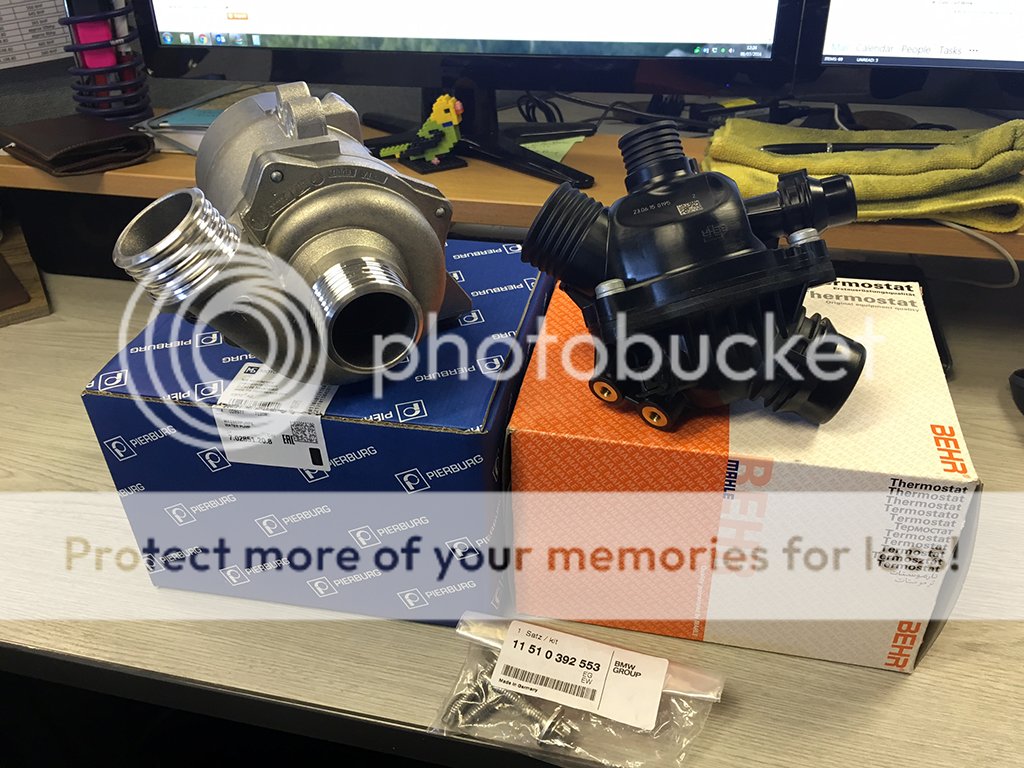

Yep, my supplier provided the three genuine BMW replacement aluminium bolts with the Pierberg OEM replacement Waterpump :)
Just out of interest, where did you source the pump and thermostat from? Starting to think I should get one of these in, just in case!
I got the Waterpump and Aluminium bolts from Sam at BM Autoparts in Birmingham. Sam is a very helpful bloke and will even check the part number against your Chassis number to ensure correct fitment. Really good guy to deal with and even answered my e-mails at 6.30pm on a Sunday evening!
They trade on eBay and are the Cheapest in the UK for a Brand New Pierberg pump
- eBay Listing - N52 Pierberg Waterpump + Bolt set
The thermostat I bought from GSF car parts as they were the only place I could find a BEHR thermostat.
Sam at BM Autoparts also does a Pump + Bolts and Thermostat kit for £285.00 inc Delivery which is a cracking price!
- eBay Listing - N52 Pierberg Water Pump + Bolt set + Wahler Thermostat
The American N52 owners seem to swear by the Wahler Thermostats, but I went for a BEHR one on account of my local BMW dealer friend checking a brand new BMW one on the shelf and it having the BEHR logo on it :)
The Bluecol OE48 coolant I got from Andrew Page, but this can also be got cheapest from Motorworld's eBay Store
- eBay Listing - Bluecol OE48 Anti-Freeze - 5 Litres
