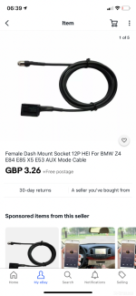

I too have just bought a coupe and I’m working through a list of stuff to change/fix.
I bought an Aux cable off eBay for the stupidly cheap price of £3.26 delivered. Fitted on Friday and it works flawlessly. See pic for details.
Proper easy. Remove vents above radio, unscrew radio and pull forward. Then if you don’t have Bluetooth simply connect the 12 pin plug and route the wire to where you want, drill hole and job done.
If you have Bluetooth like me it is slightly more
Involved but still easy.
