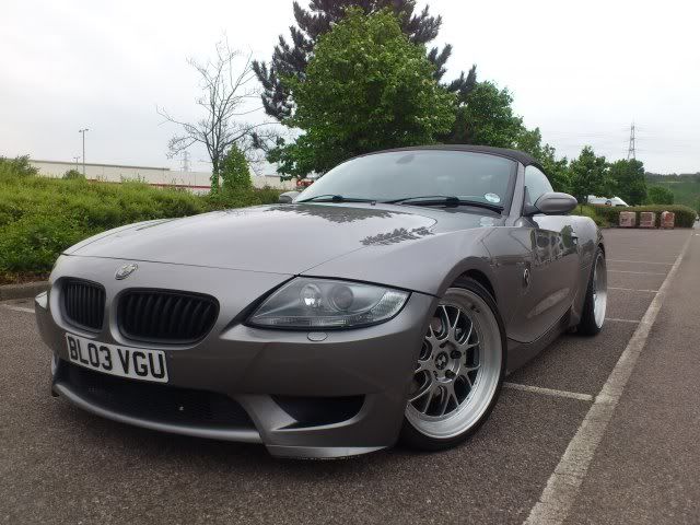

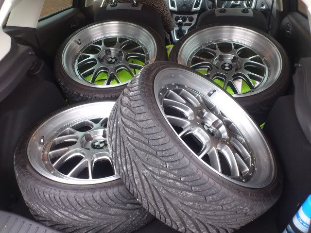

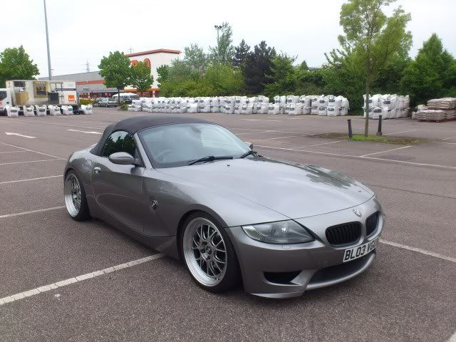

paid a visit to stug's house today and bought these lovely looking wheels from him. i must say, his zed is one of the cleanest i've seen. it looked brand new 8)
after a long trip (260 miles in total) and countless traffic jams on the way home (M4 and M25 around rush hour is mental!) i got home and rushed to get them fitted.
no i didn't get these in the z4 :lol: took the other halfs focus and managed 47.5mpg over the whole trip. not bad for a 1 litre turbo petrol :thumbsup:

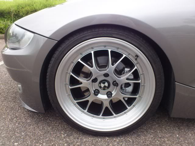

wheel specs are:
8.5x19 fronts with 235/35/19's
10x19 rears with 265/30/19's
i have some rubbing issues when going over speedbumps, more than likely due to mine being lowered. hopefully i can sort it out.

They look great Ben :thumbsup:
With the rubbing I had it too :headbang: try and check if its the plastic or the metal lip. Plastic easy heat gun-hair dryer warm it push it warm it push it drive it check. Repeat until you feel like your listing your mind!!
Meatal rubbing is easier get the rolled. Or get brave and do it yoursef :evil: it will most likely crack the paint :(
Love that indeed... Especially as lowered and M front.
Aero skirts really would finish it off.
Not a chance it's going any lower, it's rubbing just from general driving!
If anything it needs raising.
