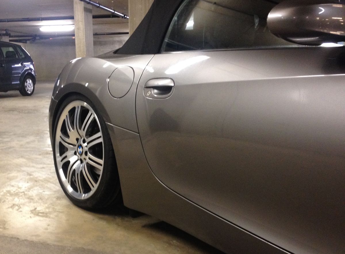

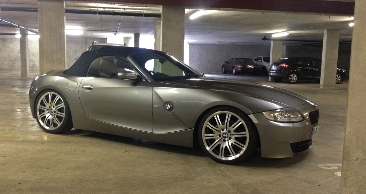

I think your Z looks great with the M3 wheels on I have always been a fan of that style :thumbsup:
I think you're slightly underplaying it :P it looks pretty awesome with them on id say :thumbsup: top job lets have another look :driving:

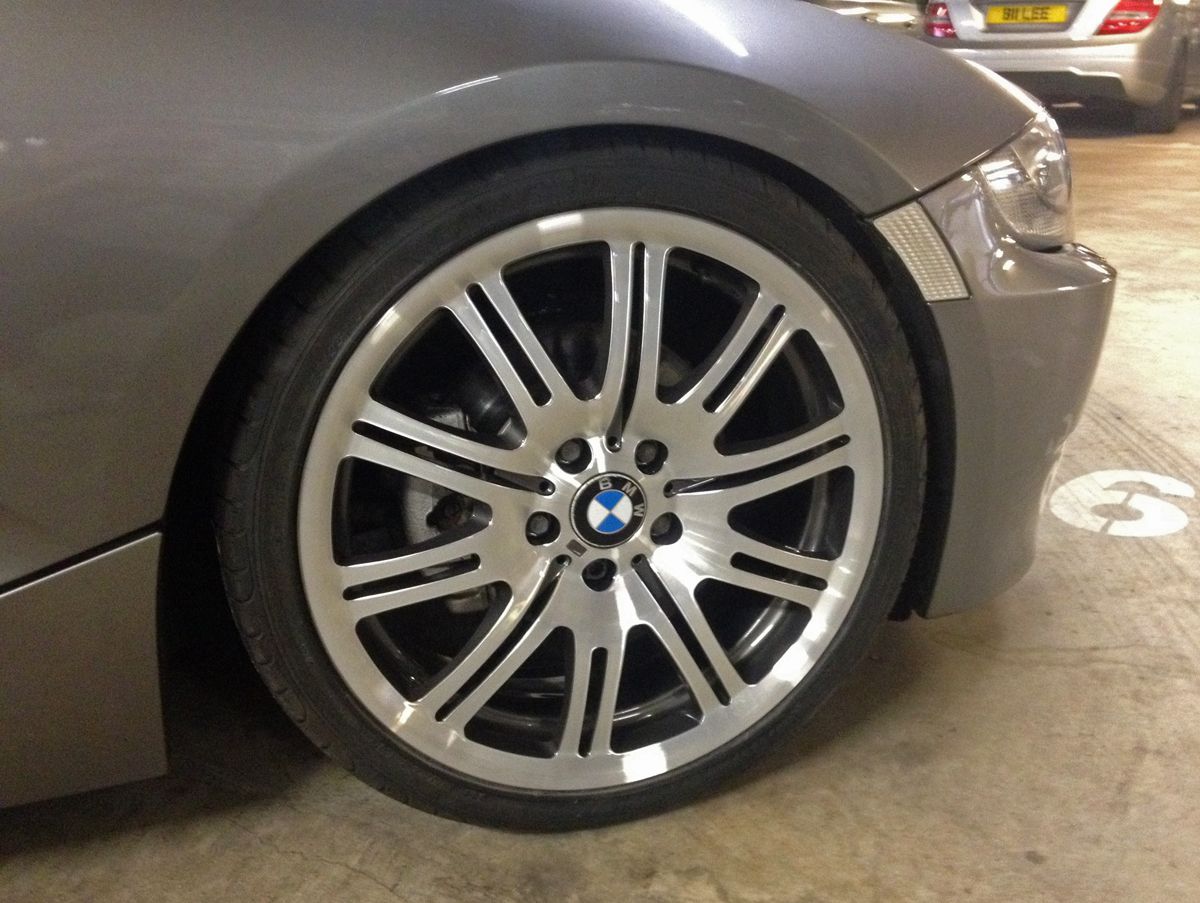

I used lepsons, they've done a fantastic job and have been great through the whole process.

The combination of the wheels, springs and spacers really does completely change the look/stance of the car. Does give it the wow factor. I know that sounds like stating the obvious but how many times do you see posts where someone has changed the wheels or lowered it (or both) and you think yes it looks different/nice but you think to yourself, its not that much of an improvement especially for the costs involved. But you have really nailed it there. Your's and Mr Wilks' comments on wheel tyre size options have got me re-thinking the whole wheel thing again. Just when I had finally made my mind up to keep my 107s and get them refurbed! :rofl:

The total price was £380+ VAT, and I had to pay about £20 extra to have some welding done on one wheel as they needed to add a little metal for a deeper kerb rash. I also got Lepsons to supply and fit the tyres too, this obviously depends on which tyres you go for.

The offset for the front 19 inch E46 M3 wheels is 41, compared with my original 18 inch 107 Ellipsoid wheels which have an offset of 47. This means that the M3 wheels stick out a further 6mm compared with the standard 18 inch Z4 wheels. Both are 8 inch wide.
If you try to source 4x front wheels, just take care. There are a lot of replicas out there. I bought mine individually totaling less than £200, what you don't want to do is buy 3x genuine wheels, and 1 replica!
