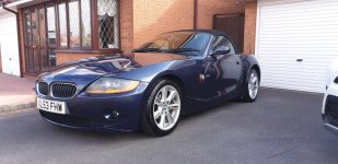

Hi all,
I have just bought a new to me 2003 2.5 e85 as bit of weekend toy. I have recently been lucky enough to be given a company car, which meant selling my own personal bmw f30 m sport. However the company car is a bit boring, and I needed something to help scratch my itch.
The car I have bought is generally ok, but needs a bit of TLC. It shines up well from a good wash, but I can see it has few oil leaks. Mostly from the rocker cover, which is dripping oil on to the exhaust manifold and I get some smoke when stationary. The other appears to be from the oil sump gasket, but doesn't look to severe. I have decided to replace the rocker cover gasket, do have ordered the kit and aim to do this next weekend. I dont have any real mechanical experience, but the car was cheap enough that I thought it warrants me having a go at some DIY maintence as I have always wanted the opportunity to have a go at these kind of things.
Anyway, wish me luck and aby advice is welcomed
Thanks

Hi, that looks a nice car.
If you have no 'hands on' experience then this is probably an easy job to start with.
Best idea, in the nicest possible way, is to treat yourself like a complete novice.
Read everything twice, then look over the job and make sure you fully understand every step before you start.
Even on a simple job, take photos as you go, so you can put everything back in the right place.
Give yourself double the time it would normally take.
As it is not your daily car, you can stop at any point and finish later; helpful if you need advice before you continue.
Obviously a rocker gasket won't disable a car completely but I knew a guy who thought he'd tackle a suspension job on his weekend toy, knowing he could use his daily if he had to stop. It was only when he'd sheared a bolt on the strut mounting that he realised his daily was trapped at the back of the drive :headbang:
Have fun. Hope it all goes well.

Is that 17" wheels?
